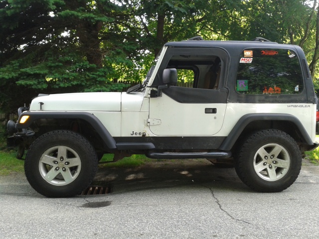

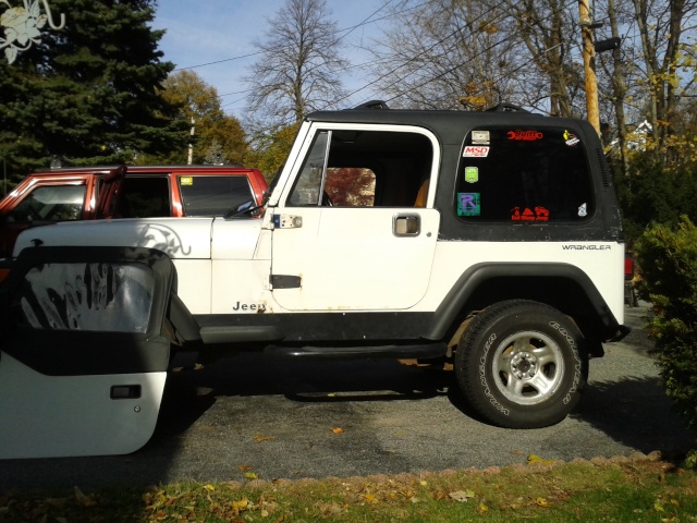

Well I got the flare extensions on this weekend and they really complete the look all around. In case no one believed me, there is some serious rot under there that needed to be covered. I did sand the good metal and painted everything to hide it best as I could. You can't see a thing unless you literally get under the Jeep and look around...which is a good thing on the inspection sticker front. All that's left to do is slap a 'Rubicon' sticker on there and start telling people I did a leaf-spring conversion on a TJ.
Before and after shots:
The Oreo (T.J.'s YJ) - Page 9 20140610
The Oreo (T.J.'s YJ) - Page 9 20140611
The Oreo (T.J.'s YJ) - Page 9 20140612
I also adjusted some of my shackle bolts in preparation for the bushing replacement this weekend. I've read on a few forums that torquing the bolts under spec will give a much nicer ride and (hopefully) better flex off road. I can't confirm the better flex part yet, but I can definitely say that going from ~115 ft./lbs. down to 85 ft./lbs. on the shackle-to-frame bolt definitely made a noticeable difference. I will be torquing the spring-to-shackle bolts under spec as well this coming weekend for a better ride and to hopefully preserve the new bushings.

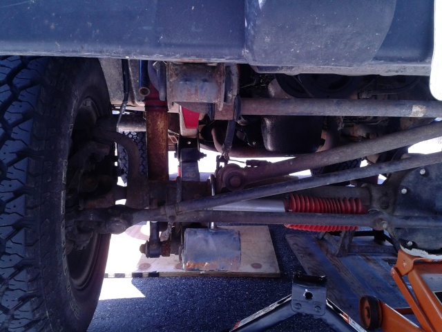

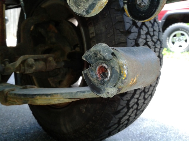

Got the new spring and shackle bushings installed this weekend, and like magic my clanging noise around sharp right turns has totally disappeared. The whole process took about six hours, but I wasn't really in a hurry so that's no big deal, and I also installed the factory spec bump stops and re-positioned the rear fender flares at the same time.
Here's a couple of shots of the old bushings to give you an idea of why they needed replacing.
The Oreo (T.J.'s YJ) - Page 9 Crap_b10
The Oreo (T.J.'s YJ) - Page 9 Crap_b11
And this shot gives you a glimpse into how off the front axle is. The drivers side is even worse, which might explain why the bushings there (second photo) were toasted. I will try and address this alignment issue soon, which I think is a combination of the u-bolts being slightly out of place and a track bar that's too short. Might be time to invest in an adjustable one.
The Oreo (T.J.'s YJ) - Page 9 Crap_b12
It seems the cause for the bushings' untimely demise was a combination of bolts that were over-tightened and the improperly aligned front axle. This time around I torqued the shackle to frame bolts at 80 ft./lbs. (about 35 ft./lbs. below factory spec) and the spring to shackle bolts at 60 ft./lbs. (also about 35 ft./lbs. below spec) both front and rear. I tightened the center shackle bolts to somewhere around 50-55 ft./lbs., I say that because I just tightened them using the 60 ft./lb setting on the wrench but didn't want them quite as tight. I also greased the bushings before sliding them into place in hopes that that would help their longevity as well.
We'll see how long these ones last before they bite the bullet. Initial observations are that bumps are definitely smoother (the removal of the rear track bar and keeping the sway bar 'permanently' disco'ed up front helped here too) and as noted the god awful clink has disappeared. You can sort of see from the photos where it looks like there was some metal on metal contact between the shackles and the springs, which explains the noise. This quells my fears of the noise being something costly and time-consuming like a bad hub or other steering component failing in the front axle.

Post  CrawlingForward on 6/23/2014, 2:42 pm
Question....why are you still running a track bar at all?
It's not needed with YJ springs and it appears to be causing a lot of issues.
Am I remembering that you couldn't get it out? If it's causing this many issues, it might be time to grab the saw-zall or get a shop to drill it out (or just cut off the damn bracket)

Post  THOOPY3 on 6/23/2014, 6:13 pm
I keep it on because I'm a bit leery of taking it off the front end; there's something about it that makes me uncomfortable despite the advantages I know I'd probably gain. If this one becomes the trail machine though I'd most likely take it off. Honestly the ride has been great just from keeping the sway bar disconnected; much softer and I can't tell any difference in the body roll around heavy corners. It would probably come off fairly easily if I tried, I just haven't tried haha.

Post  CrawlingForward on 6/23/2014, 6:27 pm
I mean, I'm never one to tell people to remove safety features, but I removed mine in '08 and haven't had an issue over 4 years of DDing.
I think you have the reverse of what a lot of guys do, which is lose the trackbar and keep the swaybar connected.

Post  THOOPY3 on 6/24/2014, 10:16 am
Yeah I've got it set up a little differently than most do. And I will say, the track bar is definitely limiting the amount of flex up front (in particular droop), at least on the passenger side, because when I had the front end completely detached on Saturday only the drivers side wheel had enough flex to touch the ground (because as you know the track bar attaches to the passenger side of the axle).
I'll definitely consider removing it, but I don't know if that will happen before Rausch. If current thinking holds, Oreo will probably be getting put to the back burner for a bit to focus on Little Red. There just aren't enough days in the weekend to make it all happen quickly.

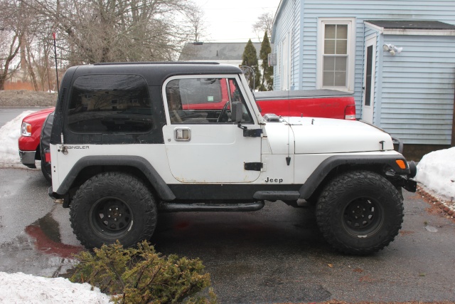

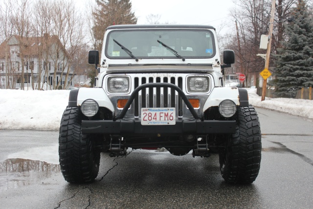

Post  THOOPY3 on 3/16/2015, 9:27 pm

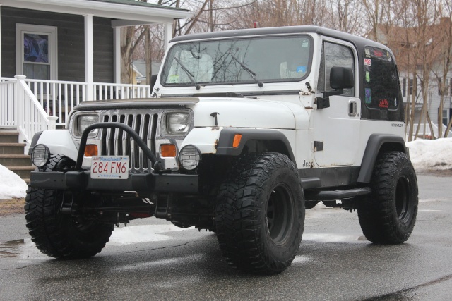

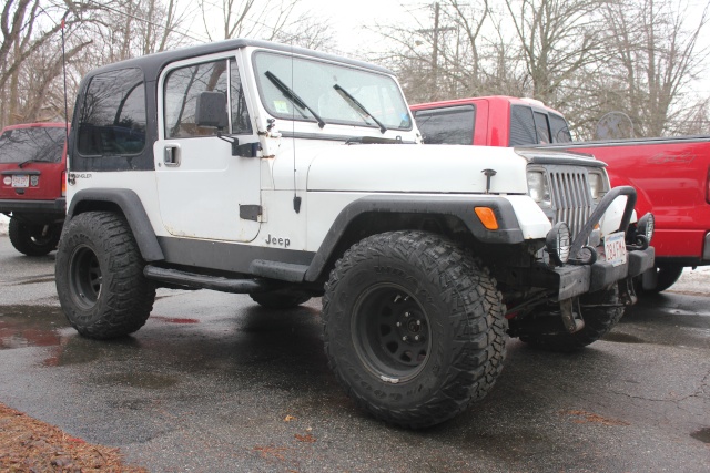

Been awhile since I updated this. Big things happening on the YJ front.
In the coming weeks we'll be ordering a Ford 8.8 from East Coast Gear Supply to replace the D35 out back. The D35 has been good to me and never given me any problems, but it's recently developed a pinion seal leak and with the plans we have for this thing it just wasn't going to cut it. The plan is to keep the gearing at 4.10 and have a Spartan locker installed, keeping it locked full time. This makes the most sense for the YJ because it is now basically the designated wheeler/occasional weekend cruiser so there's really no need for fancy air lockers or anything like that. So with that said...
This past weekend we scored a good deal from a club member on some mounted 33/12.5 Goodyear Wrangler MTR/Ks. Supposedly they only have a few thousand miles on them, and they are definitely in great shape. They came mounted on some black steelies that unfortunately have some structural issues, so we're gonna end up replacing them with 15x8s with 4 inch backspacing in the near future. And to be honest the current wheels seem like they may be 15x10s (I didn't really measure them before mounting them because we know they're coming off soon) and we'd rather have them smaller than that.
So despite all the rain/snow/nastiness we took off the 32s and swapped on the 33s. (On a side note this afforded us our first chance to try out the electric impact wrench I bought my old man as a Christmas gift and it performed flawlessly.) The 32s will not be just thrown aside however, as the plan is for me to run those on the Cherokee during club runs and when I go camping, etc. The 4.5" lift on that should provide plenty of room for those (they were on it previously after all) and I'll be bump-stopping it accordingly to prevent any fender carnage.
Now I know I'm biased, but I think the thing looks like an absolute TANK now. And I've got the street queen photos to prove it:
The Oreo (T.J.'s YJ) - Page 9 Img_1714
The Oreo (T.J.'s YJ) - Page 9 Img_1710
The Oreo (T.J.'s YJ) - Page 9 Img_1711
The Oreo (T.J.'s YJ) - Page 9 Img_1712
The Oreo (T.J.'s YJ) - Page 9 Img_1713
BEAST MODE. We took it for a few rides, both around town and highway, and all things considered the power is still there. I think that speaks to how healthy the motor is. We did run into some clearance issues on the front fenders right around full lock, but that was nothing a little massaging with a hammer couldn't fix. These tires are also quiet as all get out, to the point that my old man and I could actually have a conversation on the highway without having to raise our voices.
As you can see, it could probably use a little more lift to comfortably run this size tire off road, and the thinking at this juncture is to run Old Man Emu 2.5" springs, either with or without the current .75" shackles currently on the thing, and upgrading the shocks to Skyjacker hydros. I'm also planning on chopping the front fenders and trimming the TJ flares to give a flat fender look and add even more clearance. The goal is to keep a low center of gravity with a focus on droop. We may also add Smittybilt 3" rear tube flares for more clearance as well, but will be decided after the lift goes on.
Since we'll be adding height (albeit not a tremendous amount) we'll also be adding a SYE for the 231 and a new drive shaft. We'll also be removing the rocker guards to have the totally rotted driver side rocker and floor pan replaced professionally so we won't have to worry about it moving forward.
Up first will most likely be the SYE/drive shaft install before the new axle is put in, simply so we can actually drive the thing to and from the shop where it will be installed (Steve's Jeep Country in New Hampshire). I'll be calling ECGS probably next week to get the 8.8 ordered, and hopefully we'll get things rolling from there. I'd like to have all of this done by Go Topless Day mid-May, but that is certainly a lofty goal that we may not meet, especially since significant body work is going to take place to get the rocker and floor fixed. The good news is the lift, shocks, and axle install all go hand-in-hand so one good weekend should take care of all that.
