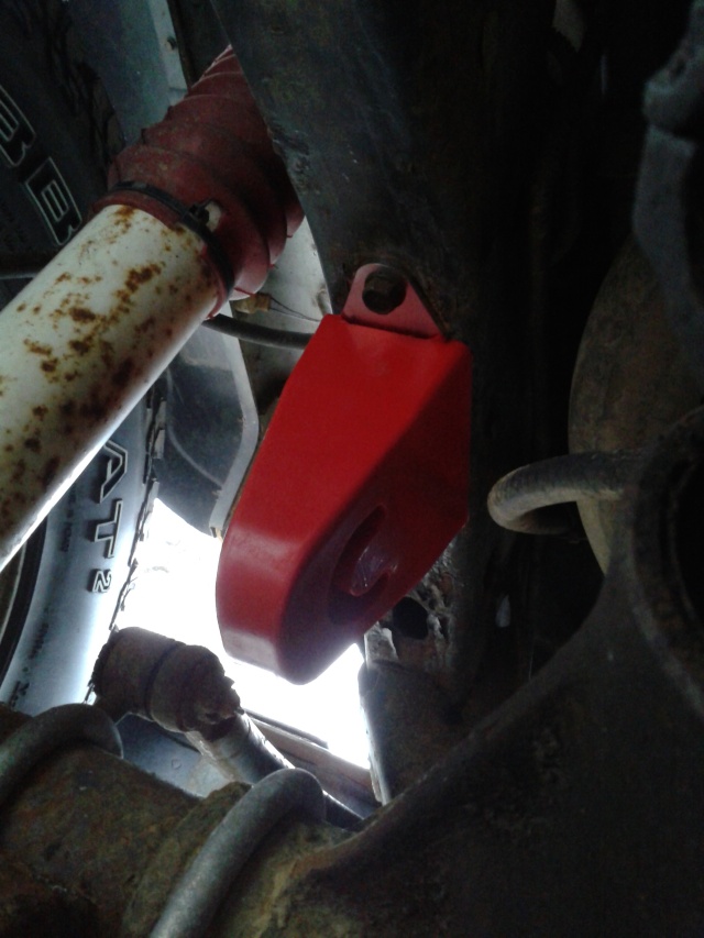

Here's a shot of the rear passenger stop, figured I'd throw this one in too only because it required the most amount of work.
Now that it's a little higher off the ground, I've been able to crawl around under there and get a better view of things too. The picture may not show it, but I have to say, the frame is in pretty damn good shape for an old New England Jeep. I'm well versed in the areas where YJs begin to rot away, and she's now 21 years old (my baby's growing up so fast) and not getting any younger, so I check on things more and more.

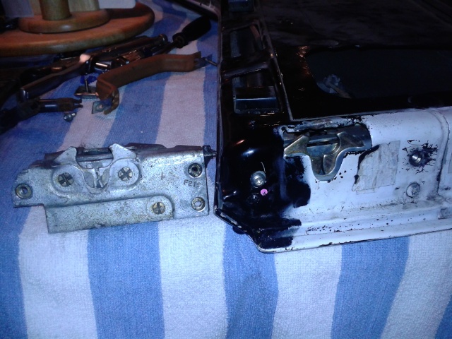

Stage one of my TJ uppers on YJ half doors project
Picked up my new half door latch today from Lawless in Woburn. For reasons unknown to me, the door stopped latching at the exact same time the slave cylinder shit the bed on me last summer. So not only did I have to bang a U-turn on Route 2 and shift without the clutch, I had to do so while holding my door closed...with a state cop following 15 feet behind me and my girlfriend in the passenger seat looking like she was gonna piss herself. Hopefully this gives you all a brief insight into why it was for sale on Craig's List three times.

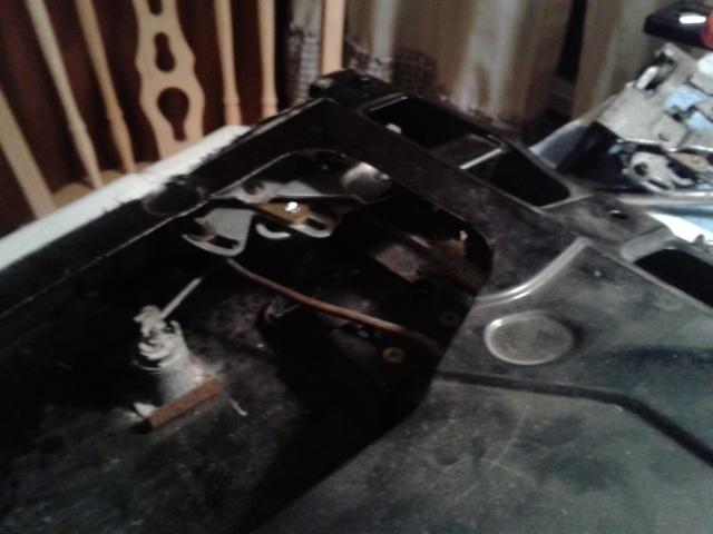

Anyway, back to the present. I started by taking the door panel off, which was surprisingly easy. Turns out you don't need to remove the inner door handle to do so. As to be expected, awaiting me was 20 years of dust, dirt, and god knows what else.
After that, I removed two of the screws holding in the weather stripping, and started on removing the screws holding the latch to the door. And of course this is where things went wrong. Two of the bolts came out no problem. Got about a quarter of a turn out of the third one and it stripped like a chick after prom. After about an hour of cuss-laced hammering and shimming, it finally came out, and I got to detaching the linkages.
Got them all detached and the old latch out relatively smoothly. Then I got started with the new latch. The only difficult part was determining which linkages to attach first to make the easiest work of it. Figured that out, got them all attached, and ba-da-bing, latch installed.
And here's a shot of the old and the new side by side.
All that's left is to find a replacement bolt for the one that stripped and the test to make sure the latch works right on the Jeep. I ran out of daylight so that will have to wait until tomorrow night or Saturday morning. All in all pretty straightforward. This is stage one of my TJ uppers on YJ half doors project for those of you keeping track. I will be picking up the TJ upper doors and skins Saturday morning from Crown Auto.
