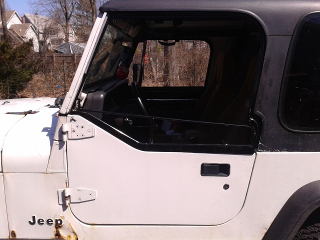

The half doors are a success. All the mechanisms work as they should and the door opens and closes smoothly. I picked up the TJ upper frames and skins from Crown Auto Saturday morning and test fitted them. The spacing seems perfect in comparison to the pictures I've seen in all the various write-ups I've read. All that's left is to cut the rear pin and find someone to weld it back together, and possibly chop about an inch off the bottoms of the front pins. Here's some pics to show how everything looks:
The Oreo (T.J.'s YJ) - Page 3 Half_d10
The Oreo (T.J.'s YJ) - Page 3 Half_d11
Of course as usual, it's always two steps forward and one step back. During one of my deliveries Saturday I'm pretty sure the driver side axle U-joint shat the bed, as I now have a lovely crunching sound when the wheels are cut and spinning. As a result, it will be in the shop for a few days to have that and my O2 sensor replaced, and I no longer work as a delivery man. I've broken far fewer things on the thing wheeling than I did working that damn job.

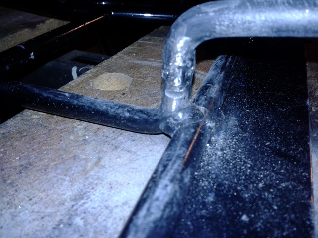

Post  THOOPY3 on 4/18/2013, 10:45 pm
So thanks to Ryan, the door project is now all but complete. I owe him all the credit for this stage, as the cutting and welding was all done by him at his house using his tools. There are a few pictures of the frames before and during the process on his camera, so unfortunately I don't have those pictures available at the moment.
The process was fairly straightforward (at least it seemed that way from the bleachers). The passenger door went extremely smoothly, as we got the length and angle right on the first try. Unfortunately we ended up chopping off too much on the driver door and Ryan had to weld some of what we chopped off back on, and grind it down from there to get everything where we wanted it. Other than that though, everything went great. They're a tight fit in the door inserts, but I have a feeling that will be a benefit to me and there won't be any play when I'm driving. (I want to mention that the term "we" actually means Ryan, but simply saying Ryan implies that the mistakes were all his fault, which is false. Errors were a group effort Laughing.)
Tonight I wire-wheeled the welds, filed a few jagged spots down, and hit them with some trusty paint/primer in-one. Since they won't be exposed to the elements I'm not overly concerned about a perfect finish. Tomorrow after work I will be putting the skins on the frames and test-fitting everything. If all goes well, the doors will be going on and I will be good for summer. Now I just need to find a place to store the full doors. Hopefully I have positive things to report tomorrow.
Here's some pics of what I did tonight:
The Oreo (T.J.'s YJ) - Page 3 Frame_10
The Oreo (T.J.'s YJ) - Page 3 Frame_11
The Oreo (T.J.'s YJ) - Page 3 Frame_12
(All the white spots aren't a crappy paint job, it's just the flash from my phone's camera reflecting.)

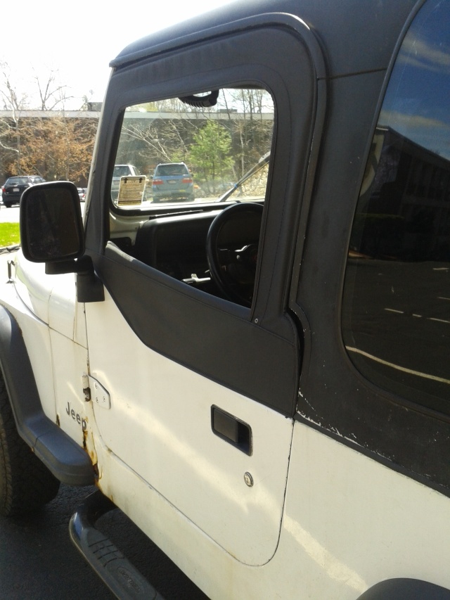

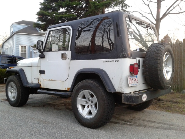

Post  THOOPY3 on 4/24/2013, 1:58 pm
Well folks, after three days and outrageous amounts of adjustment, the doors are a success. Again big shout out to Ryan for his help. The passenger side is still a little tight, so I may have to mess with the hinges a little more, but I don't get in on that side so who gives a damn. Other than that though I'm golden. I did end up adding a "gasket" on the bottom of the hard top all around to raise it up about a 1/4 of an inch to make everything just right because my doors physically cannot sit any lower or they wouldn't close. No water inside after the rain yesterday (which was really my main concern) so game on for the rest of the summer. As a tremendous added bonus, the colors of the uppers and the top are pretty much spot on so nothing sticks out like a sore thumb.
The Oreo (T.J.'s YJ) - Page 3 Upper_10
The Oreo (T.J.'s YJ) - Page 3 Upper_11
The Oreo (T.J.'s YJ) - Page 3 Upper_12

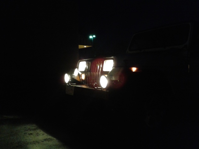

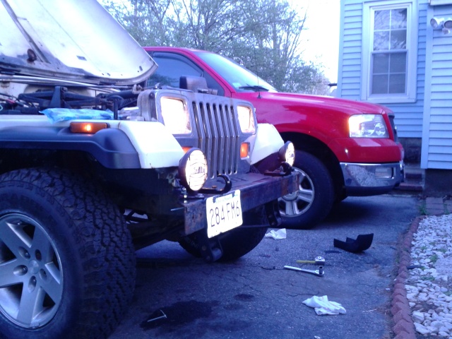

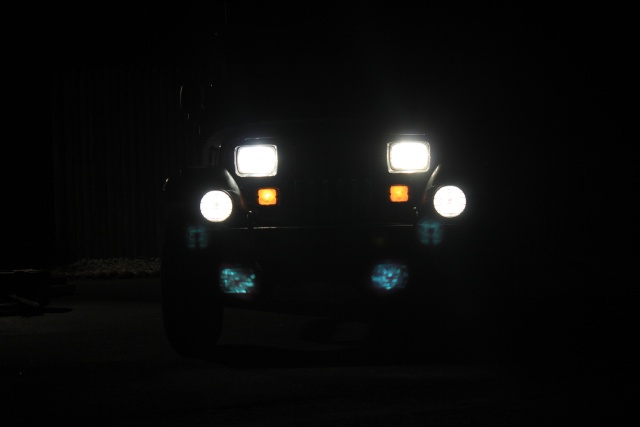

So before fixing up the rust, I figured it was about time I got my new fog lights re-installed. (If you're confused, you should be.) I decided against mounting them on the brush guard I had, but just mounting them on the bumper meant they stuck out past the edge. So I made some mounts out of quarter inch plate, drilled a few holes in the bumper, and voila, fog lights mounted and good to go. It feels good to be able to see the sides of the road again.
The Oreo (T.J.'s YJ) - Page 3 20130410
The Oreo (T.J.'s YJ) - Page 3 20130411
The Oreo (T.J.'s YJ) - Page 3 20130412

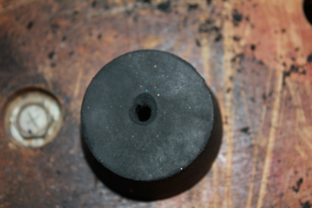

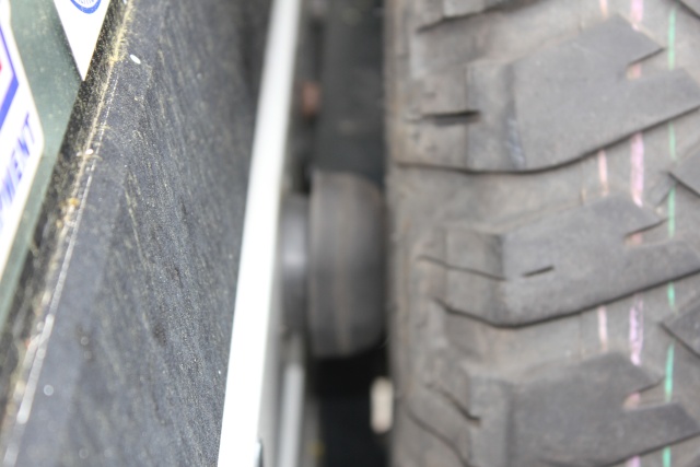

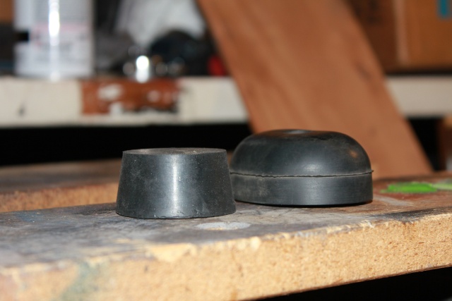

So since I put the full size spare on a few weeks ago it's been rattling around because of the different offset on the rim. I finally decided to correct the problem and make some tire stop "extensions" to stop this from happening. Two 1.625" rubber stoppers cut in half and drilled, four longer bolts, and mission accomplished.

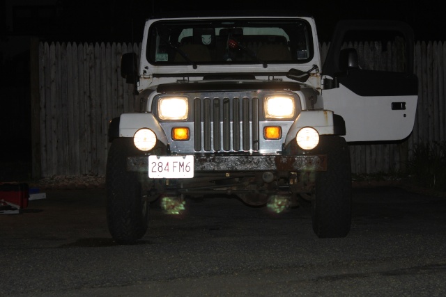

And here are some higher quality photos of the fog lights I installed a few weeks ago:
The Oreo (T.J.'s YJ) - Page 3 01110
The Oreo (T.J.'s YJ) - Page 3 01310
The Oreo (T.J.'s YJ) - Page 3 01410

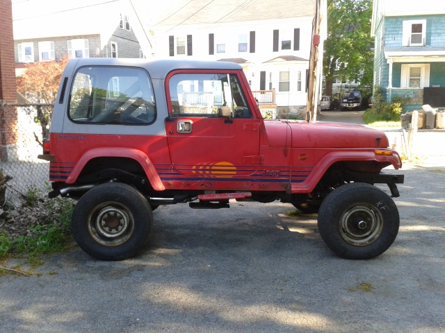

I thought I'd post this up here since I was drooling over this puppy this morning. Took the Jeep to Edwards Auto Repair in Woburn for a quick welding job and saw this puppy. It's an '89 sprung-over with a 502 engine mated to a 700R4 tranny. The axles are Chevy/GM (not sure which) one-tons. It's even more awesome up close. His plan is to put 38s on it and make it a street cruiser for him and his wife, with the occasional trip in the mud.
The Oreo (T.J.'s YJ) - Page 3 Beast_10
I told him about the club and he seemed pretty interested. He also told me about a (supposedly) 160+ acre off-road park in Winchendon that's $10 a day per vehicle and has various difficulty trails for any kind of rig. He didn't have the name but I'll be sure to look it up. It's also not often I give a mechanic tips on how to fix and improve a Jeep, but I think this is the first one he's ever owned himself (and not just worked on) and it was nice to be the advice giver for a change.
