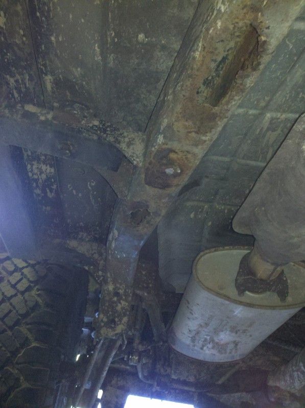

Everything has been a struggle pretty much. This thing is fraught with rust on every fastener. But that's the fun of it...or something? So anyway, after I did the suspension lift, I was getting a bad driveshaft vibration when pulling away from a stop. I guess I needed a transfer case drop or a SYE. Due to the kindness of awesome fellow jeepers on this forum, I was gifted a transfer case drop. Unfortunately, when I went to install it, most of the nuts inside the frame were rusted out and just spun. Sweet, so now I can't get my skid plate off. It took me a few days to come to my senses. I honestly thought about scrapping the thing. But I got the repair sections and welded them in. Since the skid plate now sits a little bit lower, I didn't need the drop kit! BONUS! So...enough talking, onto the pictures.

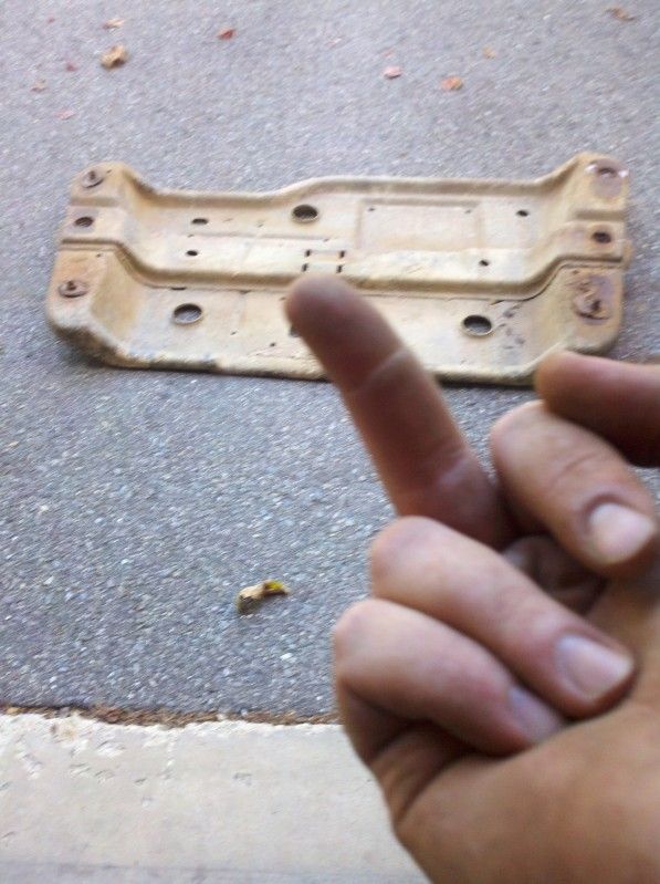

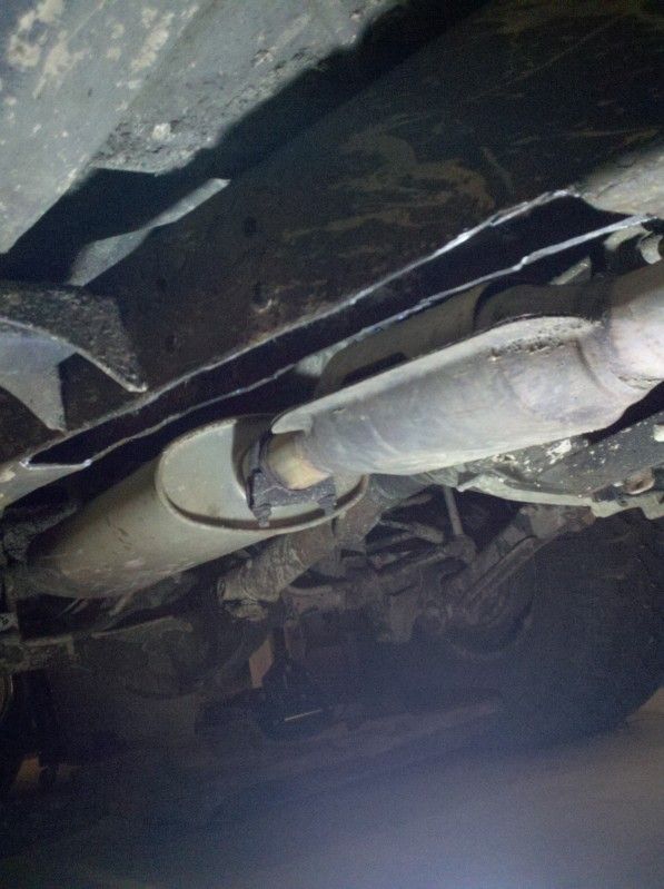

Problem:
Rob's 97, nothing crazy IMG_20120923_161235
Solution:
Rob's 97, nothing crazy IMG_20120923_090737

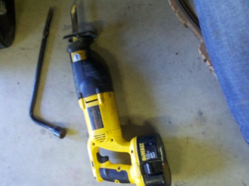

Had to bust out some O.G. multi-tools:
Rob's 97, nothing crazy IMG_20120923_154652
And finally got the skid plate down:
Rob's 97, nothing crazy IMG_20120923_160340
That's a heavy-ass plate.

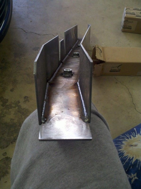

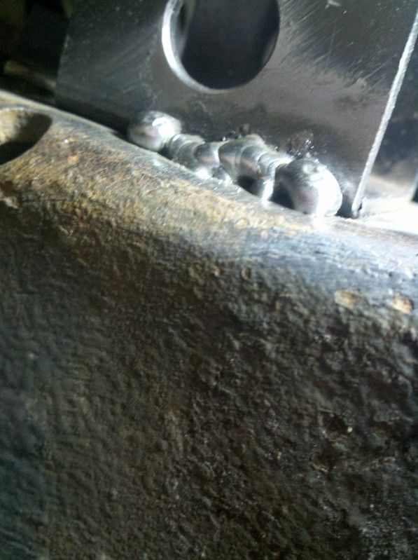

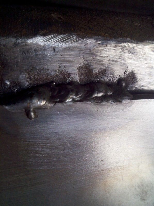

Did some quick practice welds:
Rob's 97, nothing crazy IMG_20121007_154213
They look like garbage, I know. I hadn't welded for at least a few years before this. This part was just for a spacer, part of the body lift.
Got a bit better in doing the frame sections:
Rob's 97, nothing crazy IMG_20121008_101108

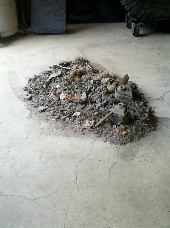

I saved all the crud that fell from in, on or around my frame during this process. It was probably about 10-15 pounds:
Rob's 97, nothing crazy IMG_20121010_165805
You can see the old motor mounts for reference.

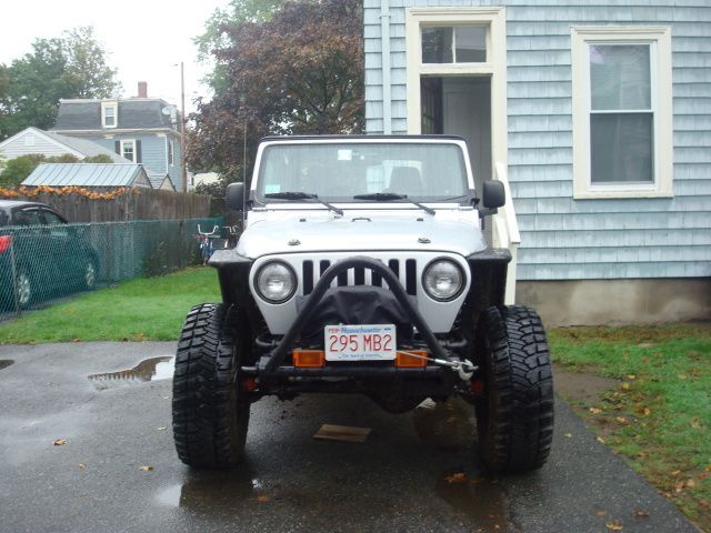

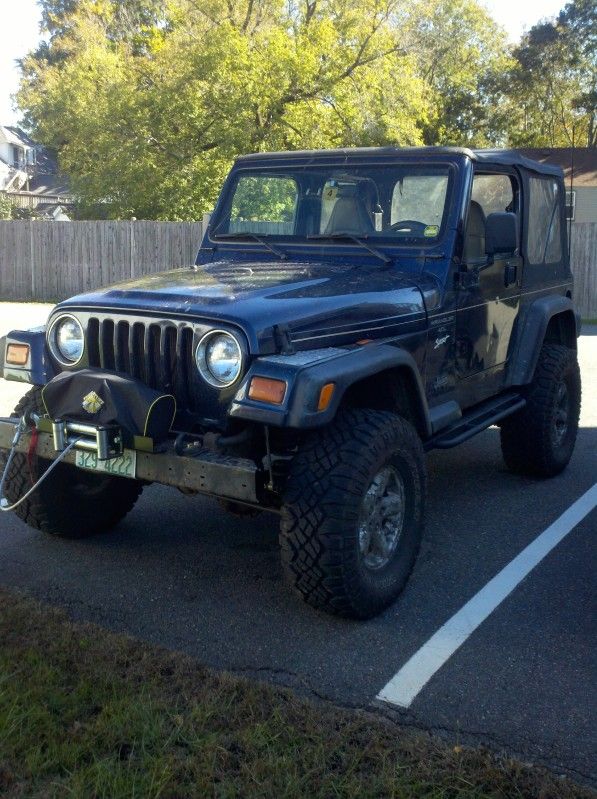

Rob's 97, nothing crazy IMG_20121013_132911
Today I decided that I will call her Stella. Smile

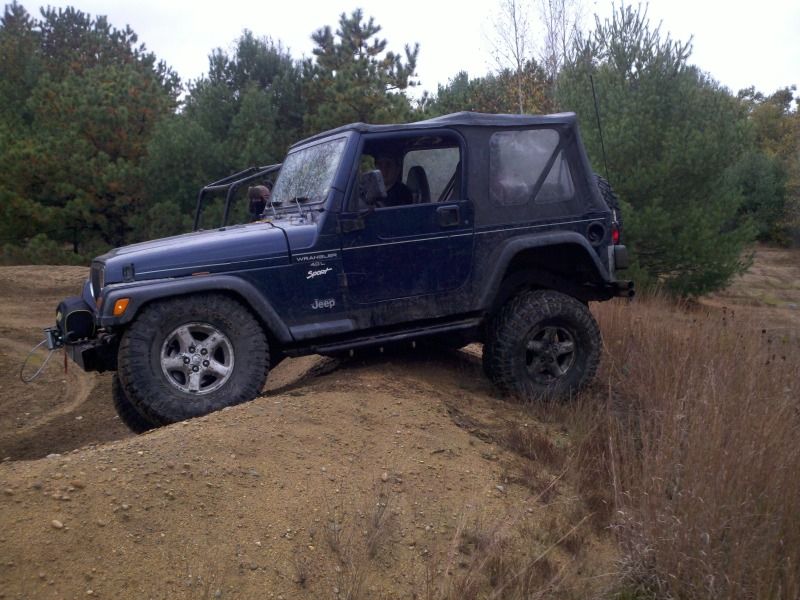

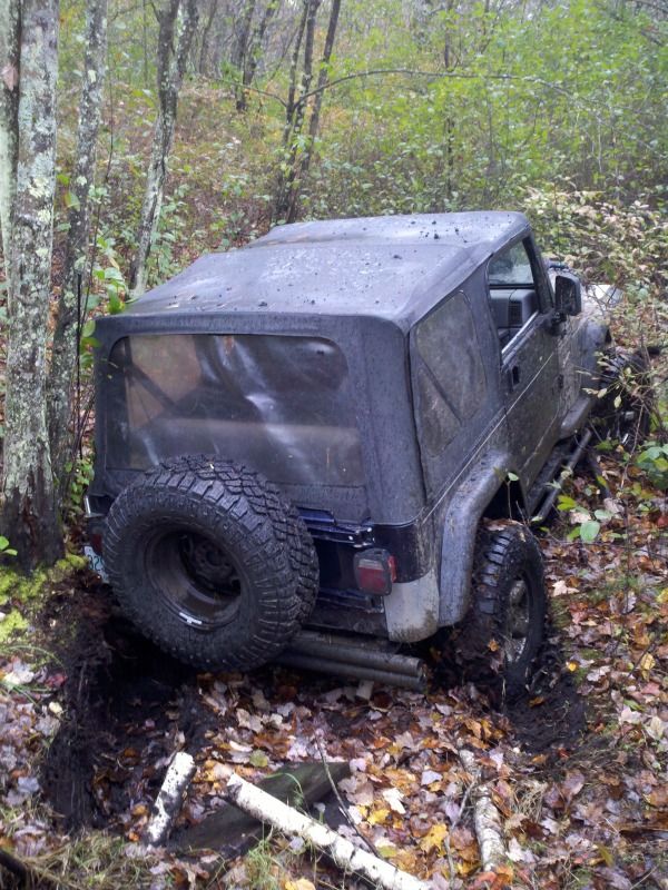

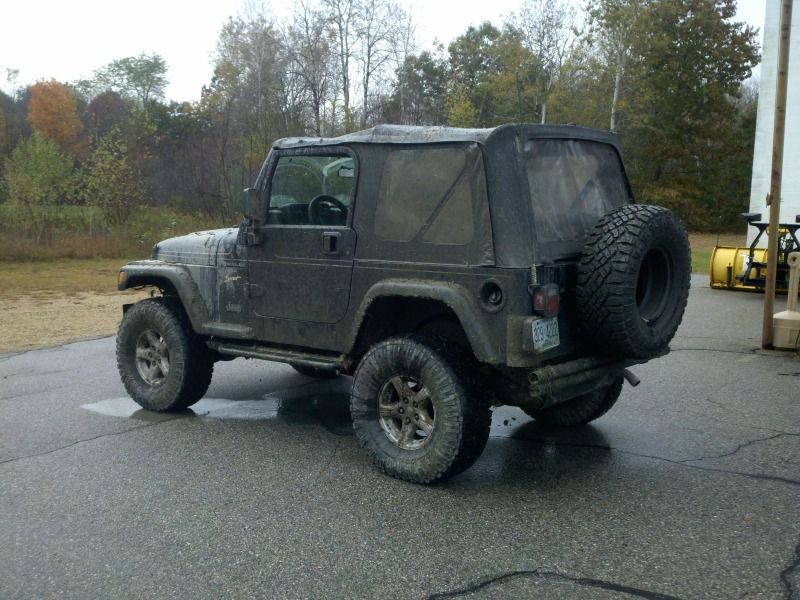

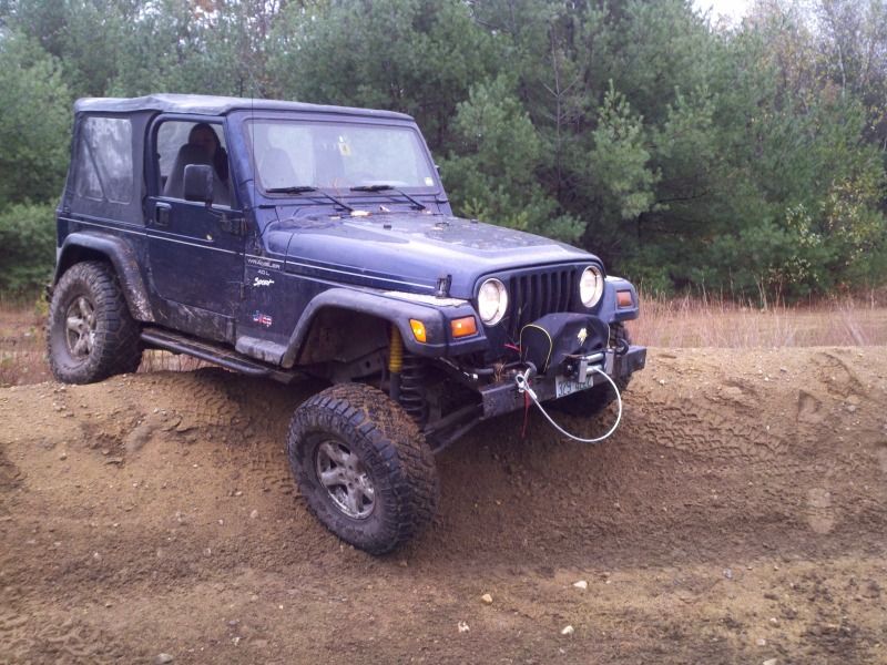

It's a good job I got that body lift done because:
Rob's 97, nothing crazy 2012-10-14_12-38-20_164
Rob's 97, nothing crazy 2012-10-14_12-38-58_296
Only had about a half inch to the fender in this pose.

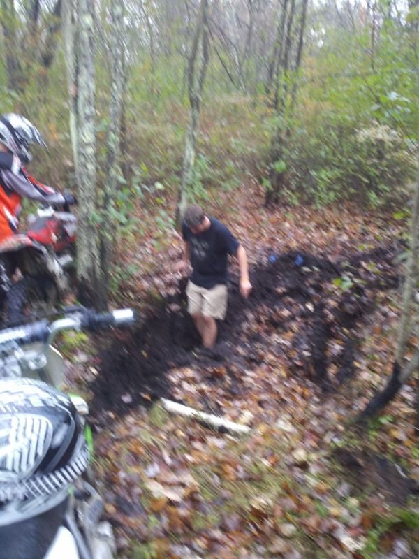

Got 'er REAL stuck, played an epic game of winches:
Rob's 97, nothing crazy 2012-10-14_13-38-37_242
Rob's 97, nothing crazy 2012-10-14_13. -32-17_70
The whole area around here was just mushy. Total surprise plowing into a ditch too. Oops. It was much more enjoyable with help to get me out, though. Then we tossed my cousin into the mud:
Rob's 97, nothing crazy 2012-10-14_14-11-17_922
The aftermath:
Rob's 97, nothing crazy 2012-10-14_15-46-55_895
She's a tank Smile

Rob's 97, nothing crazy Empty Re: Rob's 97, nothing crazy
Post  janesy on 10/14/2012, 9:41 pm
You really don't want to be leaving your winch slacked out like that... Pull it in tight.
janesy
janesy
Posts : 330
Join date : 2012-04-03
Location : Beverly, MA
Post  Rob Cote on 10/15/2012, 7:17 am
The manual with the winch said when it's not in use to leave it in freewheel. It's usually in a bit tighter than those pictures. Should I pull it in til the hook hits the fairlead and just leave it?
New to winch ownership.
Rob Cote
Rob Cote
Posts : 673
Join date : 2012-07-11
Age : 31
Location : Ipswich, MA
Post  Mark on 10/15/2012, 8:42 am
Just tighten it up and leave engaged , hook it to bumper hook and take out slack.
But do not leave it loose and free wheeling. FORGET WHAT MANUAL SAYS ON THAT ONE.
That is dangerous being loose like that.
Post  janesy on 10/15/2012, 8:47 am
Hmm, I just have done what I've seen or been told, never read my manual.
I personally like to have the spool tight and not loosen up. And if you leave it slacked out like you have it that could easily be snagged on something and do a lot of harm...
I leave mine engaged, have the hook hooked to the recovery point and pull it in nice a snug. I don't see any harm to having a winch rated to 9k or whatever pulled in tight.

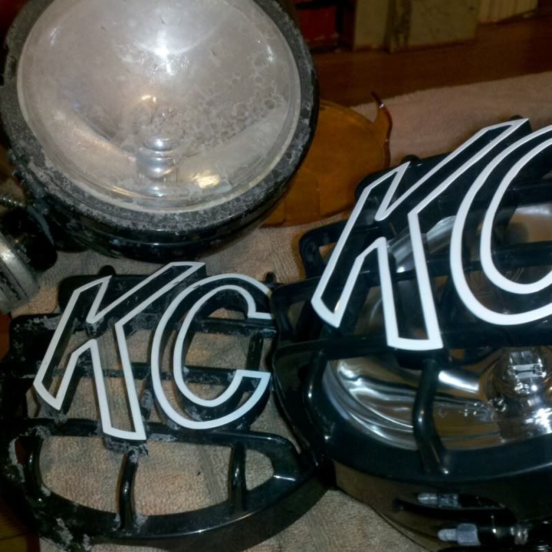

So I'm still plugging away over here. I picked up Josh's light bar, most recently.
The lights had been lightly used, but after some cleanup, they're practically new!
Rob's 97, nothing crazy IMG_20130210_204408_zps13116635
Rob's 97, nothing crazy IMG_20130212_205607_zps1678f381
I started wiring them up last night:
Rob's 97, nothing crazy IMG_20130213_214253_zpsa34cd319
