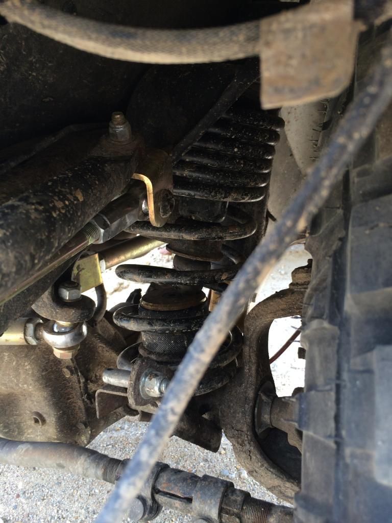

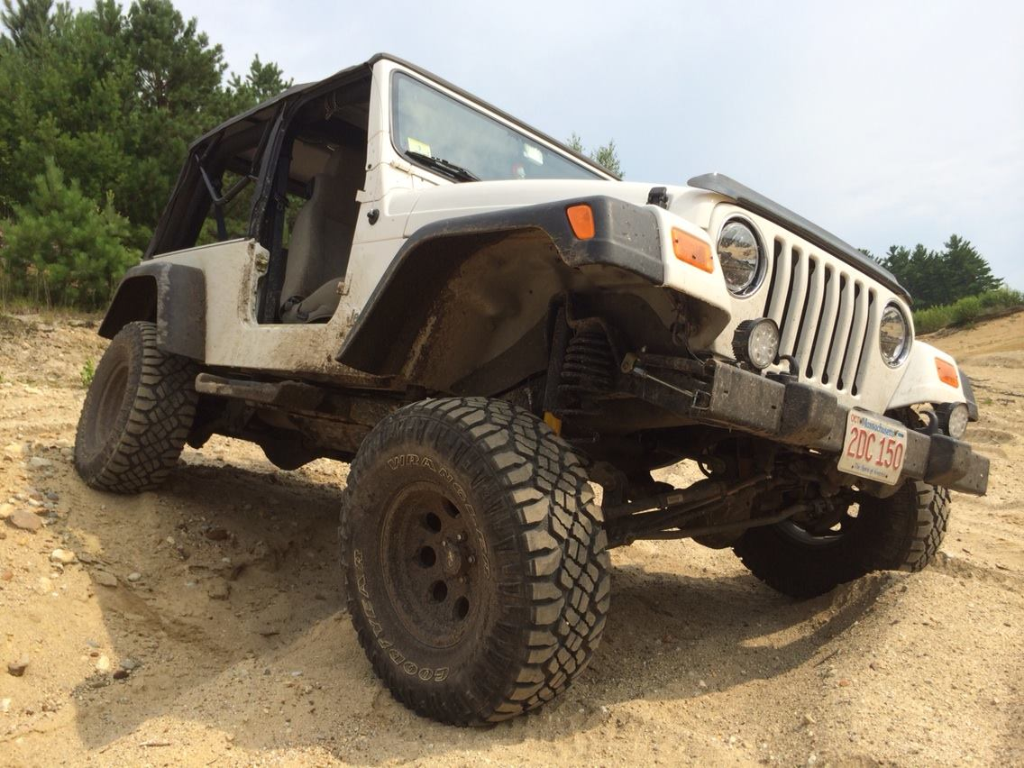

Got to test out the rig with the front sway bar disco'd. It rode even better offroad. It was super smooth and the articulation was impressive. I was able to stuff the tires without rubbing the fenders. The tires tuck perfectly. I think I might need another inch of bump stop up front though.
Not quite full stuff there was still a bit of room before the tire would hit the fender:

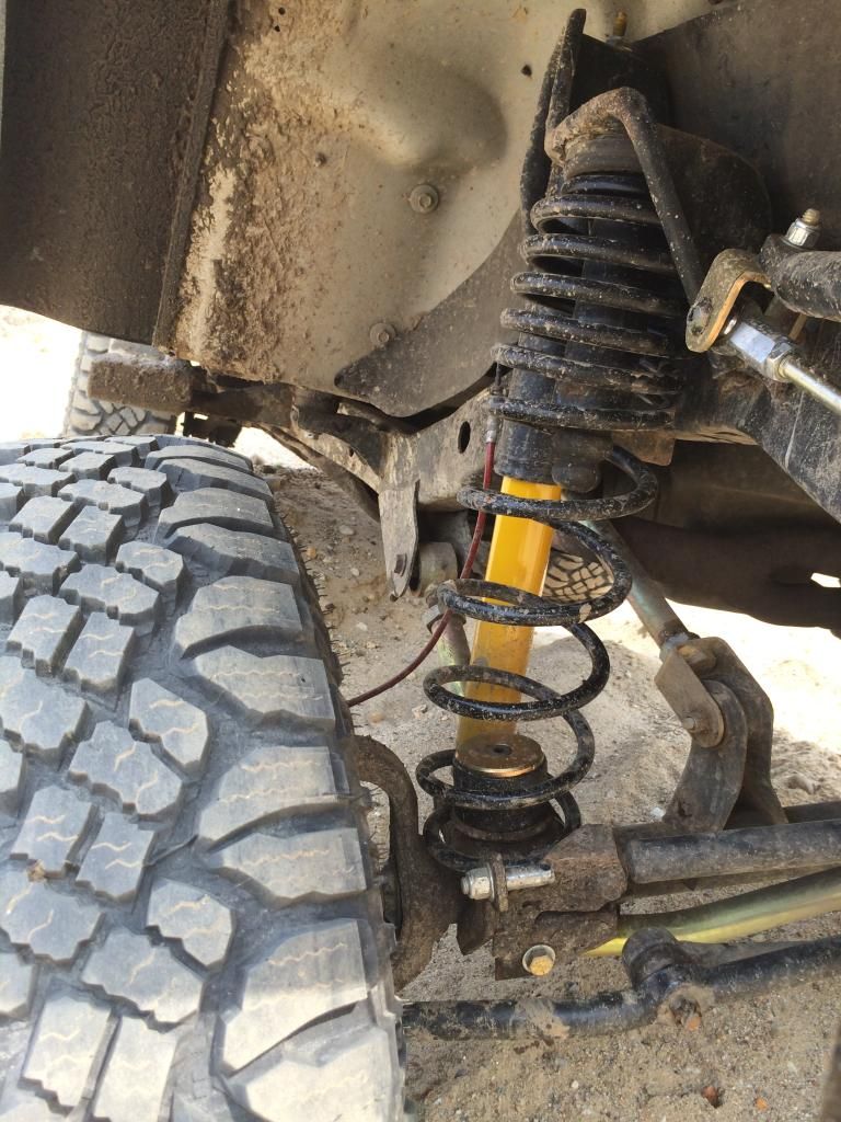

And the articulation. The springs work as advertised:
Next time out I will make sure to measure the shock lengths to see exactly where I'm at.

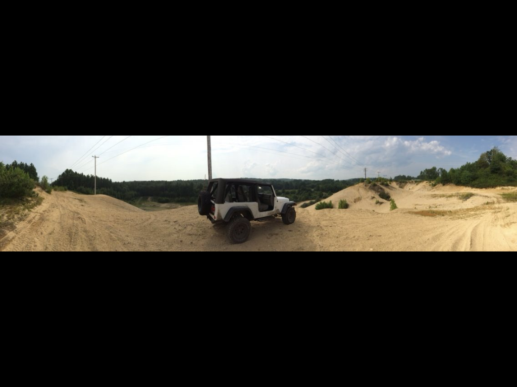

Panorama of the sand pits. This place was massive and crazy steep. I climbed one of the easier hills:

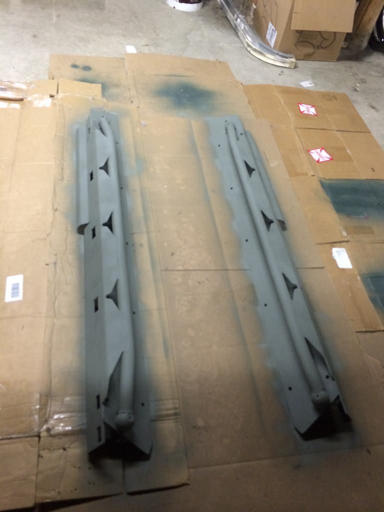

Started painting the rock rails. I used rustoleum self etching primer after cleaning with mineral spirits. The top coat is rustoleum bed liner.
Initially the bed liner didn't spray well. I put it in a bucket of warm water and realized it sprays better upside down. After that it went on very nicely. The back side will be painted with the l same primer and rustoleum flat black enamel.

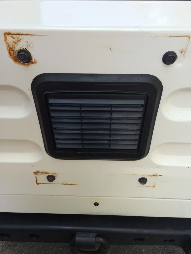

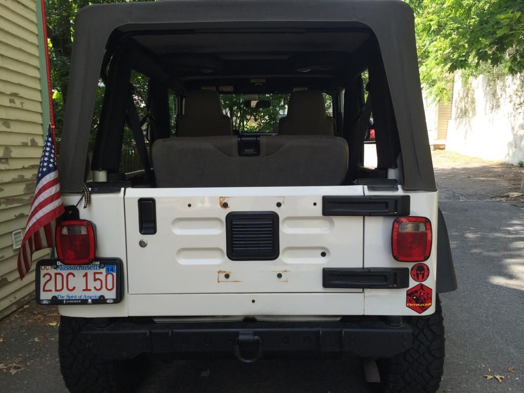

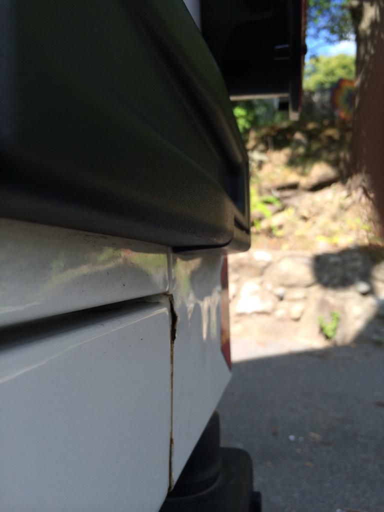

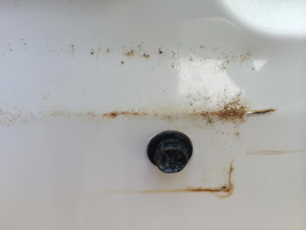

I noticed some buckling of the tub under the lower tailgate hinge. I am not sure if it was there prior to the larger spare tire but I didn't want to take any chances.
I pulled the spare tire, as I prefer the flat back look anyways.
There is some minor body work to be done as expected where the spare mount was attached.
And here is the buckling of the tub I mentioned.
I am going to look more seriously into spare tire mounting options. I am thinking I will just ratchet strap in down to the mounting points in the tub when off-roading. I highly doubt I will need it on the street I am never that far from home anyways. If I take a long trip the back seat would be out and the spare would come anyways. What do you all think?

Post  CrawlingForward on 8/27/2014, 3:03 pm
Wow. That's much more drastic than I expected before the picture loaded....

Post  dongalonga on 8/27/2014, 3:56 pm
That's why I think it was already there and I just never really noticed. The new spare honestly doesn't weight that much more than the stock wheel and heavy silent armor that was on there.
Re: Third Time's the Charm LJ
Post  Mark on 8/27/2014, 8:14 pm
That's too bad Shaun,, if it's not something it's something else,, WHEW! Maybe someone backed into something and hit the spare at some point in time?
Posts : 1296
Post  dongalonga on 8/28/2014, 5:05 am
Most likely that is what happened. I'm not all that bothered by it. I don't mind little projects here and there. I will pull the tailgate off and fix the paint. The bent sheet metal doesn't bother me as long as it doesn't rust.
