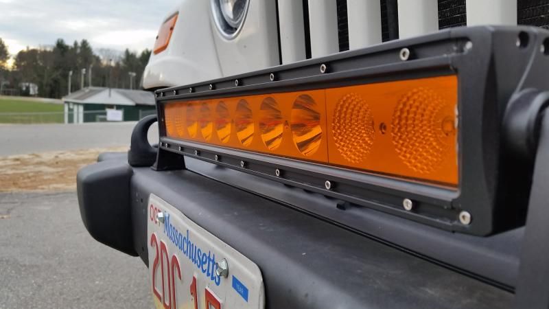

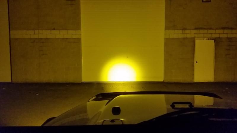

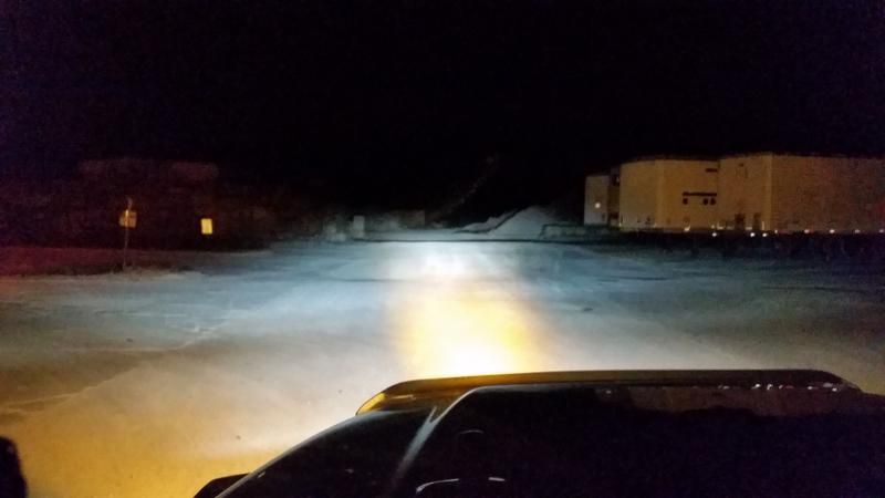

Installed the amber lens in my light bar today. Reaimed it inline with the high beams.

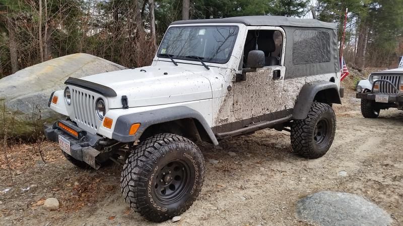

Some pics of the light bar and the rig after some cold weather wheeling today
