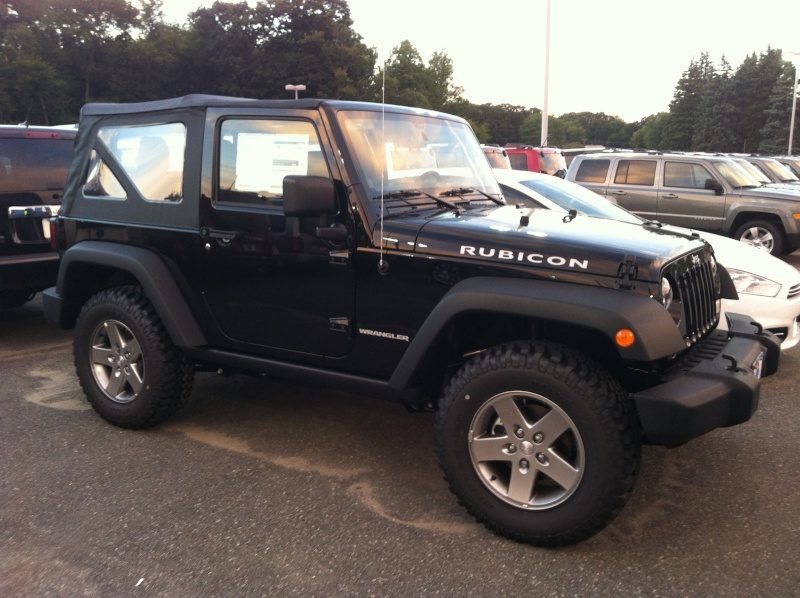

Post  dongalonga on 8/21/2012, 9:36 pm
I did something bad/good today:
05 RME Slow Build - Page 6 Img_0911
05 RME Slow Build - Page 6 Empty Re: 05 RME Slow Build
Post  CrawlingForward on 8/22/2012, 10:33 am
Oh, holy crap. It wasn't just a part-out with planning.
You actually bought it!
Congratulations! I assume you removed the old parts before you traded in the TJ, then?
Post  dongalonga on 8/22/2012, 11:09 am
Yeah I removed everything that I could without making the Jeep drive like crap. It pays to keep as much of the old stuff as possible Very Happy
Post  Mark on 8/22/2012, 11:37 am
New jk?
Post  dongalonga on 8/22/2012, 12:39 pm
yup brand new
