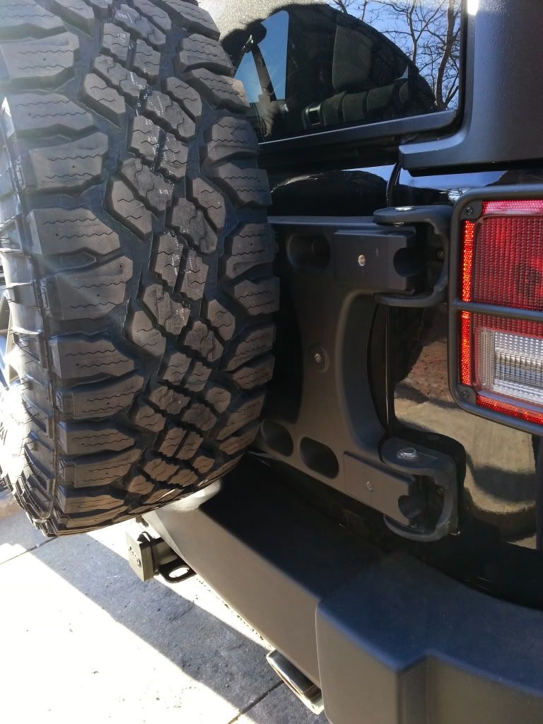

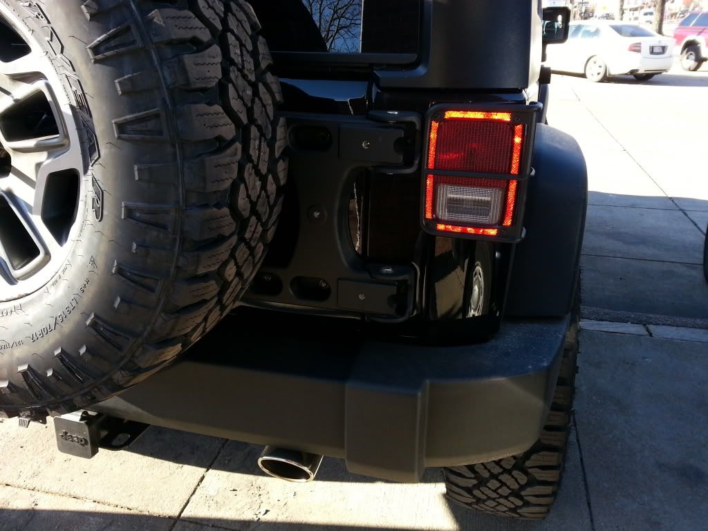

So I have the TF hinge and adjustable spare tire mount. Wanted to share some pointers
The hinge went on pretty smoothly. Pretty easy job. Only problem I really ran into was pressing the lugs into the mount. I was using the press at my friends shop and it bent the mount. Make sure to use some lube before pressing. Oh and I used a dremel to take off the tail Light from the stock carrier. That was pretty easy.
I just got 315/70/17 Goodyear duratracs wrapped around my stock Rubicon wheels. It fits on the adjustable mount! No spacer needed! The guy that mounted my tires aired down my spare first. Mounted it, and then aired it back to 28psi. He said it fits pretty snug.
All in all every is pretty solid. Now I just need to get a antenna mount..
Oh btw forget about contacting teraflex. I tried contacting them a couple of times to answer some of my questions to no avail.

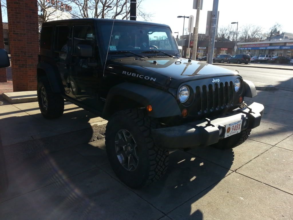

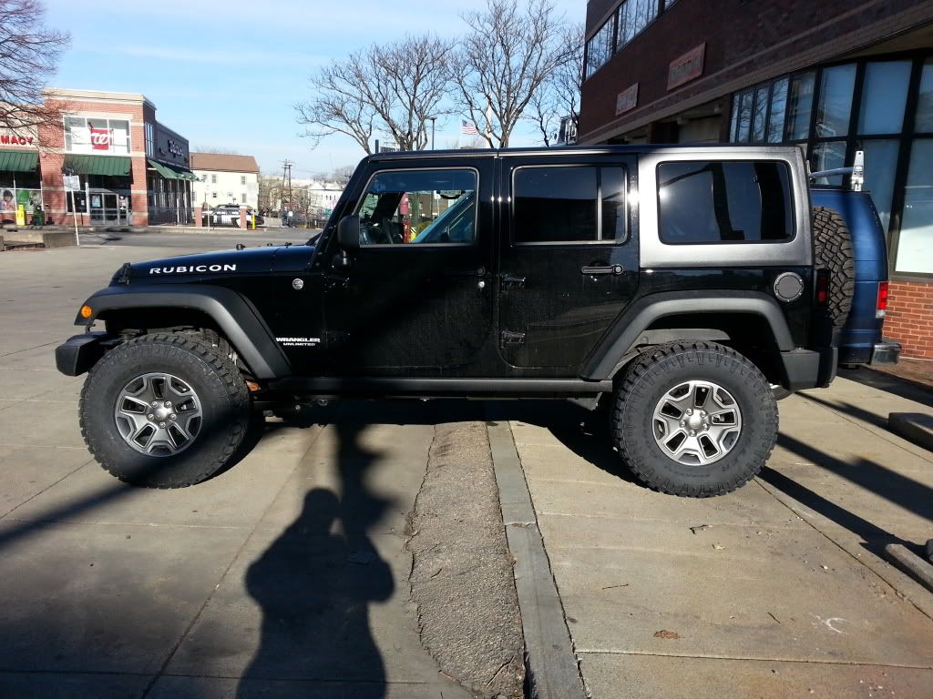

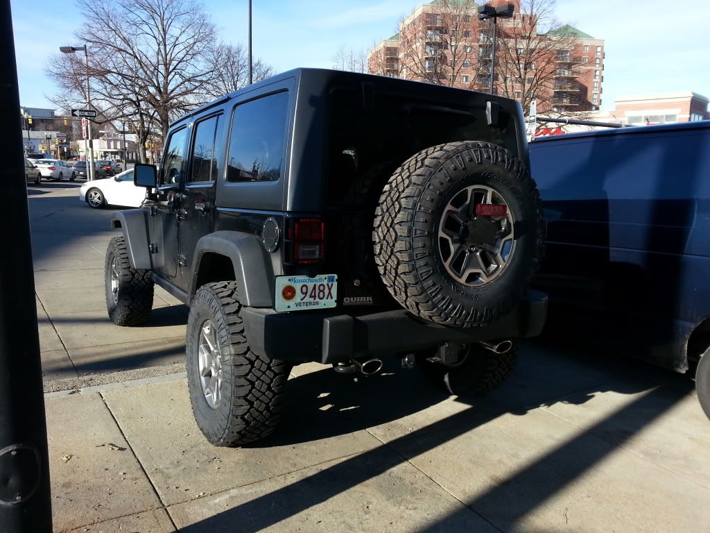

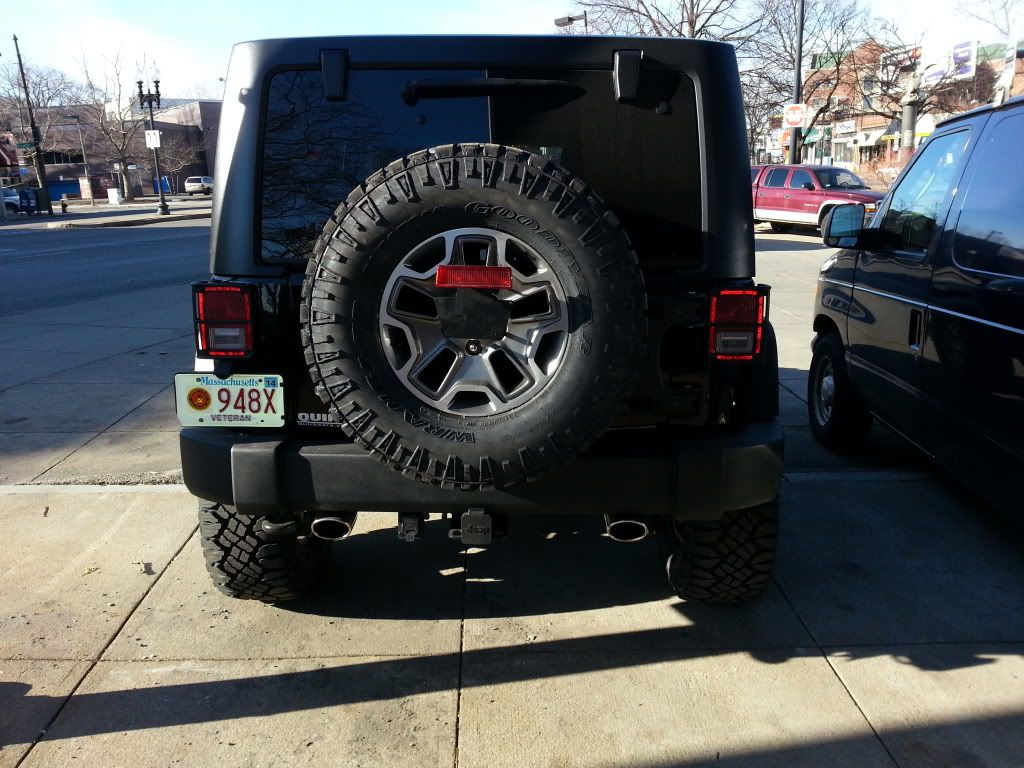

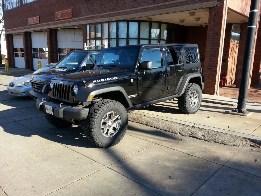

Here are the pics! Wanted to wash her first but I just couldn't wait!
rickkeo- Daily Driver
- Posts : 45
Join date : 2012-10-04
Re: 2013 Rubicon build-ish
Nice job, it looks great it's coming along nicely..
The exhaust tips give it a good look too.
