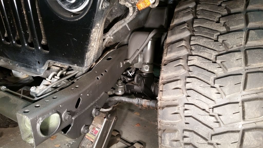

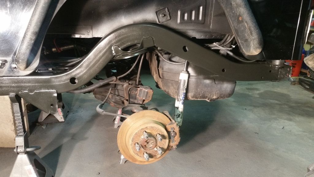

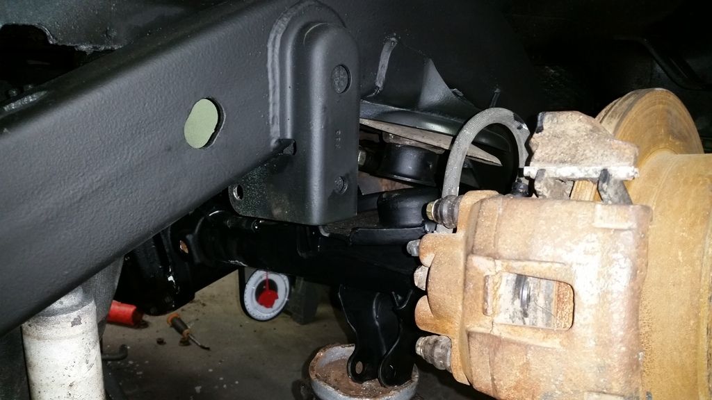

Also I can't recommend fluid film enough, these pics were taken at the same time during the 100+" of snow two winters ago
