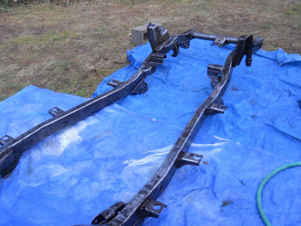

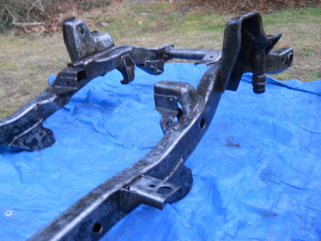

Hey guys I started a frame swap for my TJ. The frame rails just after the LCA brackets in the rear of the frame are rotting out and the body mount surfaces on two body mounts are rotted out. It's going really slow right now but it will pick up once it gets warmer out. Here is the work that I managed during a few weekends starting this January.
I used a 4 1/2" angle grinder to remove the rust that I could get to. For the smaller cracks I used 40 grit sandpaper and a wire brush as best I could. For the inside of the frame rails I wacked the sides with a hammer to remove some scale and then tilted the frame while blowing compressed air through all the holes. I removed almost all of the scale that way. After everything was cleaned up I washed out the inside of the frame with a hose and used Marine Clean and Metal Ready to prep for POR 15 on the outside. I let the Marine Clean sit for 10 minutes for each side of the frame (top and bottom). I could flip the frame by myself just be sure to put towels under the body mount brackets so they don't get dinged up. After washing off the Marine Clean I sprayed the Metal Ready on and let it sit for 30 minutes on each side. It was really cold out the days that I was grinding and cleaning so I moved the frame into the garage to dry out. It took 2 days to completely dry inside the frame rails. The Metal Ready etched the outside of the frame very well and the base coat of POR 15 went on very smooth. While the POR 15 was still tacky I applied the Flex Cote. POR 15 is not UV resistant so they recommend top coating it with Flex Cote or something similar. It took a day to do each side of the frame. Again I put the towels under points that would contact the ground when I was flipping the frame. Once everything dried and cured for two days I moved the frame back out to the car port and sprayed Eastwood Internal Frame Spray at every angle I could in the frame. It provided great coverage and I ended up using 3 cans. I should have done this part first because some of the spray ended up dripping out of the holes in the frame so I tried to clean it as best I could.

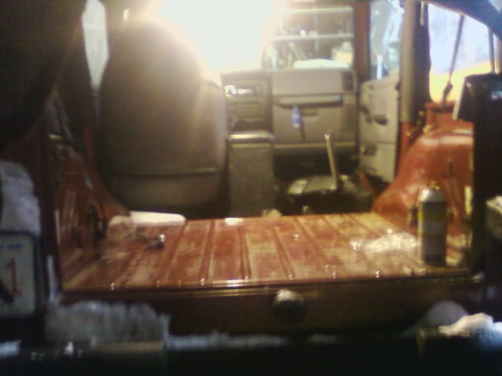

And ripping out the interior this weekend
