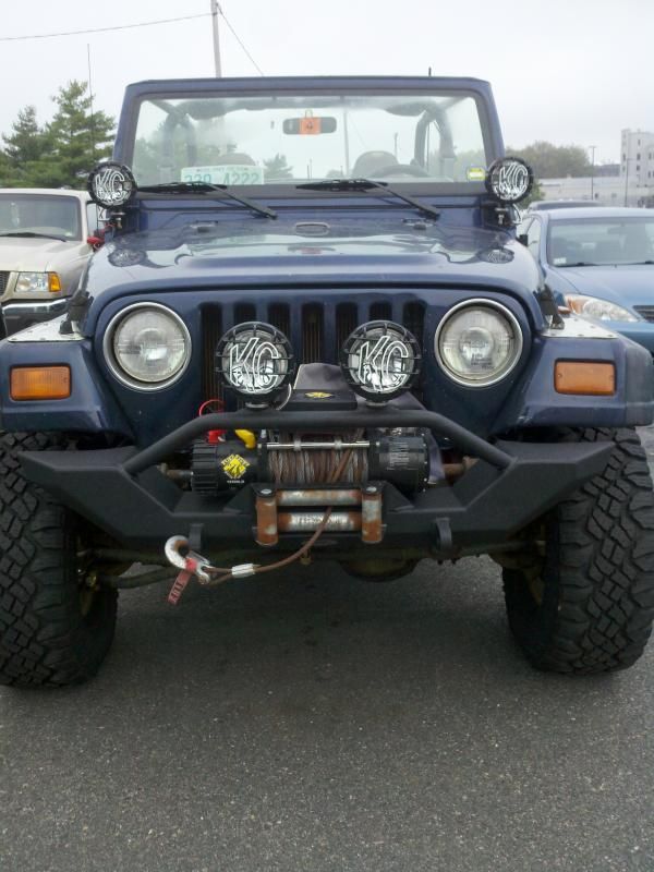

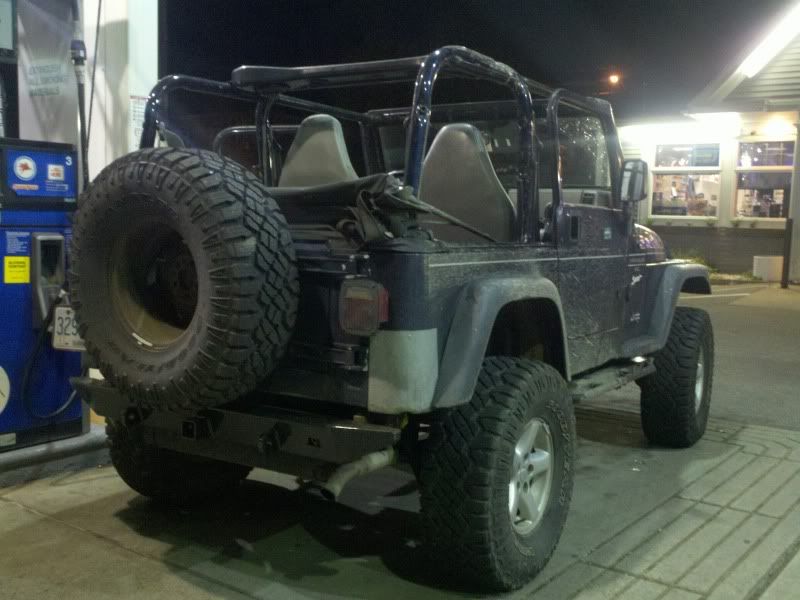

I haven't really updated this much recently. Well, that's mainly because I haven't modified anything recently. I did get this sweet Rugged Ridge rear bumper though:
I had to open up the holes in the rear cross member a bit to get it to fit. And lower the gas tank. Taking the tank out actually went much better than expected! You don't need to completely remove it, but just lower it a few inches to get some room to work in there between the frame rails. I supported it on a milk crate so I only had to disconnect the trim piece around the filler and the nuts holding the skid plate up. Do it when your tank is near empty. I didn't plan well and my tank was half full (or half empty?) and well, I'm glad I can bench press a good amount of weight because getting the tank back up without a jack was...fun.
I'll probably get frame tie-in brackets in the near future which should make this bumper significantly stronger, but I'm pretty stoked with it as is. The only thing it doesn't have is a textured finish. My Jeep is far from showy, but it would match much better if it were textured. When I get around to finishing the interior, I'll probably apply bed liner to the bumper too, while I'm at it. This bumper is super beefy though, and seems very well-built. The finish is pretty rugged and thick, too, because I've already beat it up some and it only shows minor scratches.

What I want to know is where can I get a corner patch like that ??
Bumper looks great, the one I have here is holding up well.
