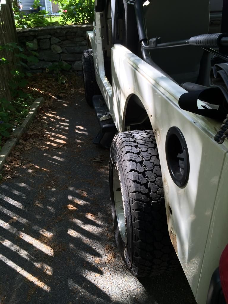

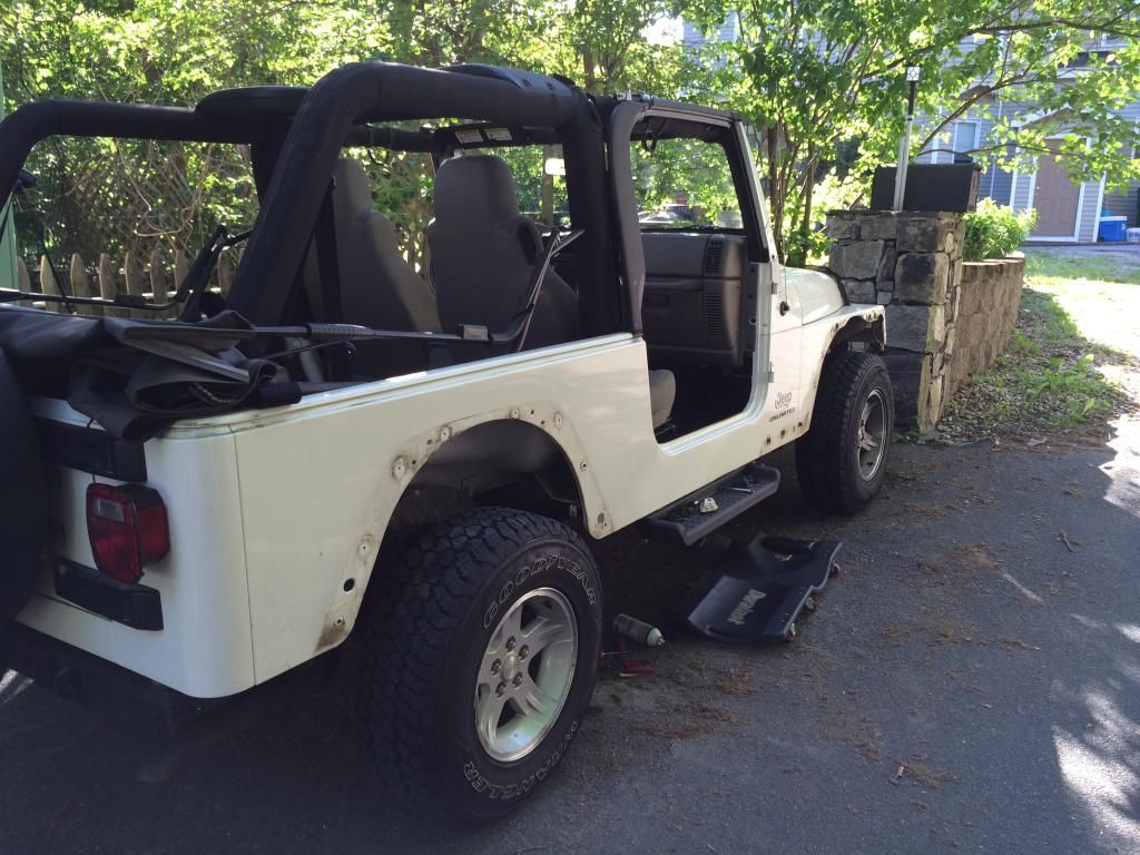

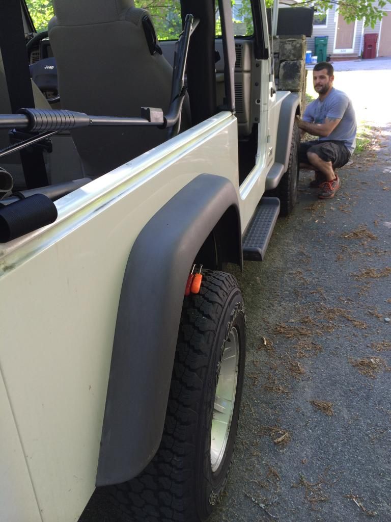

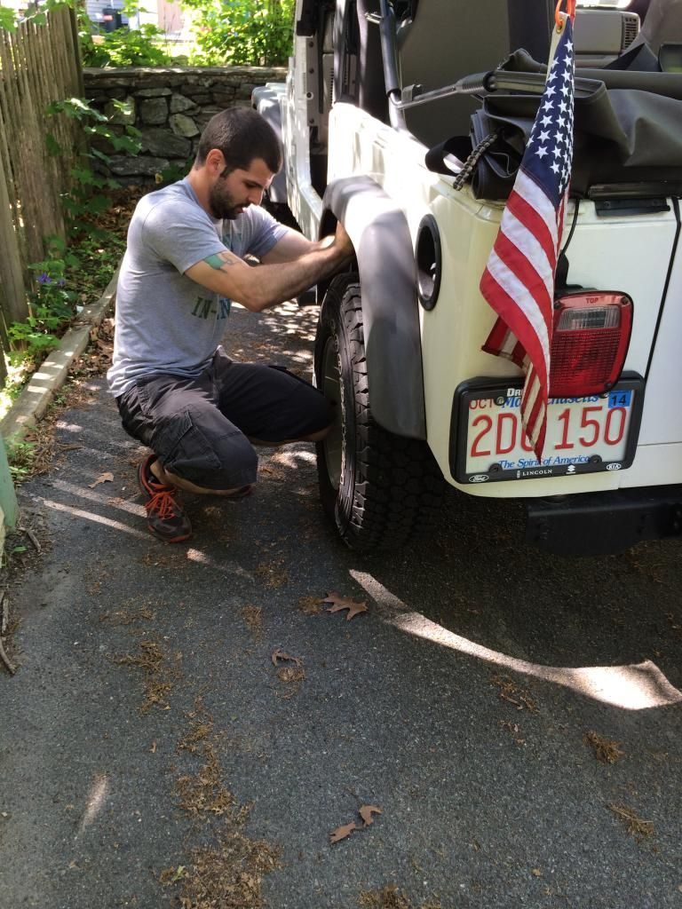

Started off switching out to the wide flares yesterday. What a pita that was. Stupid rivnuts love spinning. Eventually got the all out with Jenny's help. :
I felt like I was being watched the whole time:

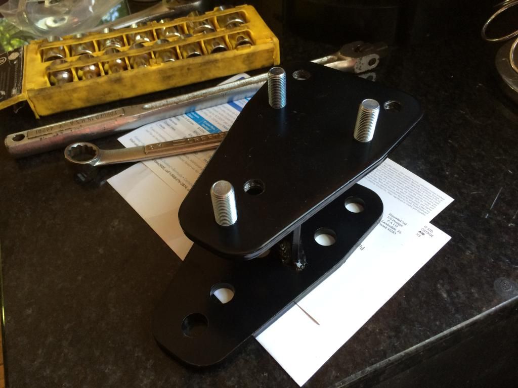

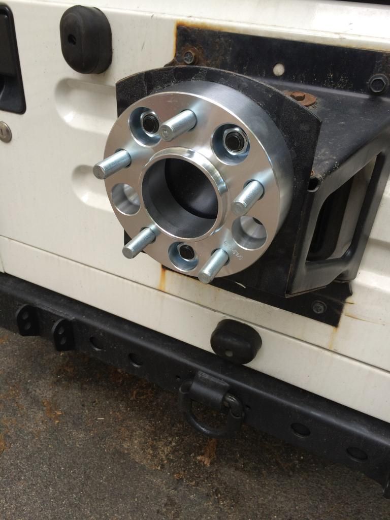

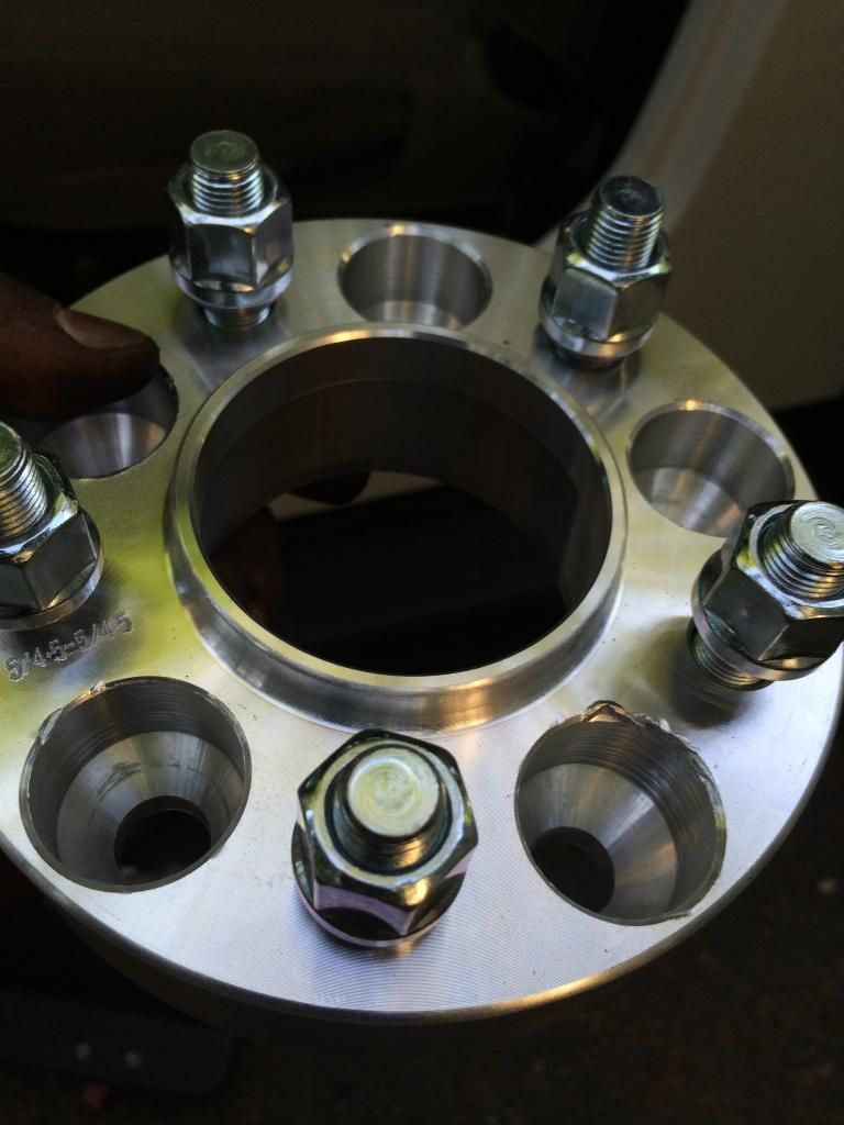

Then I installed the wheel spacers. One of them had a slight burr on it. I cleaned it up with the Dremel. I contacted the retailer and they are sending me a replacement. The bad one will get moved to the spare tire carrier:

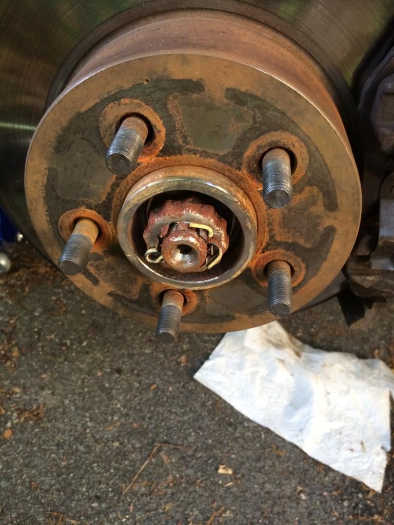

Got everything cleaned up with a wire brush and applied the red locktite:

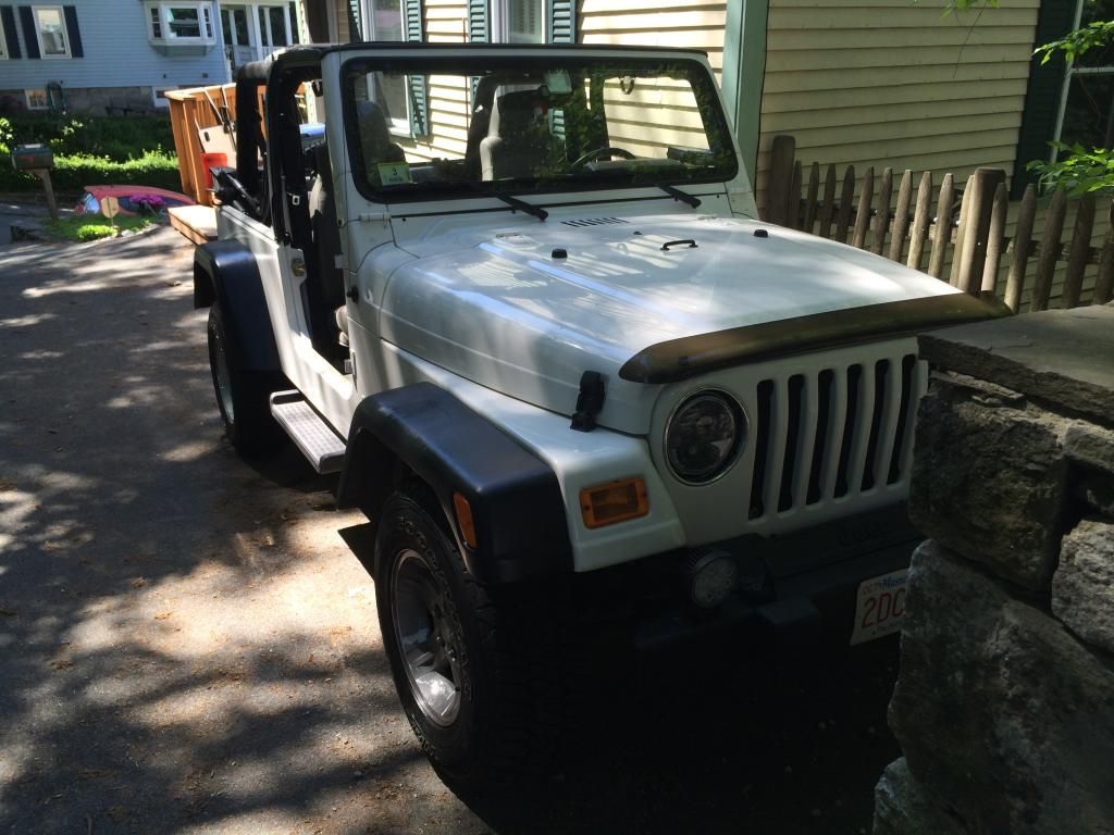

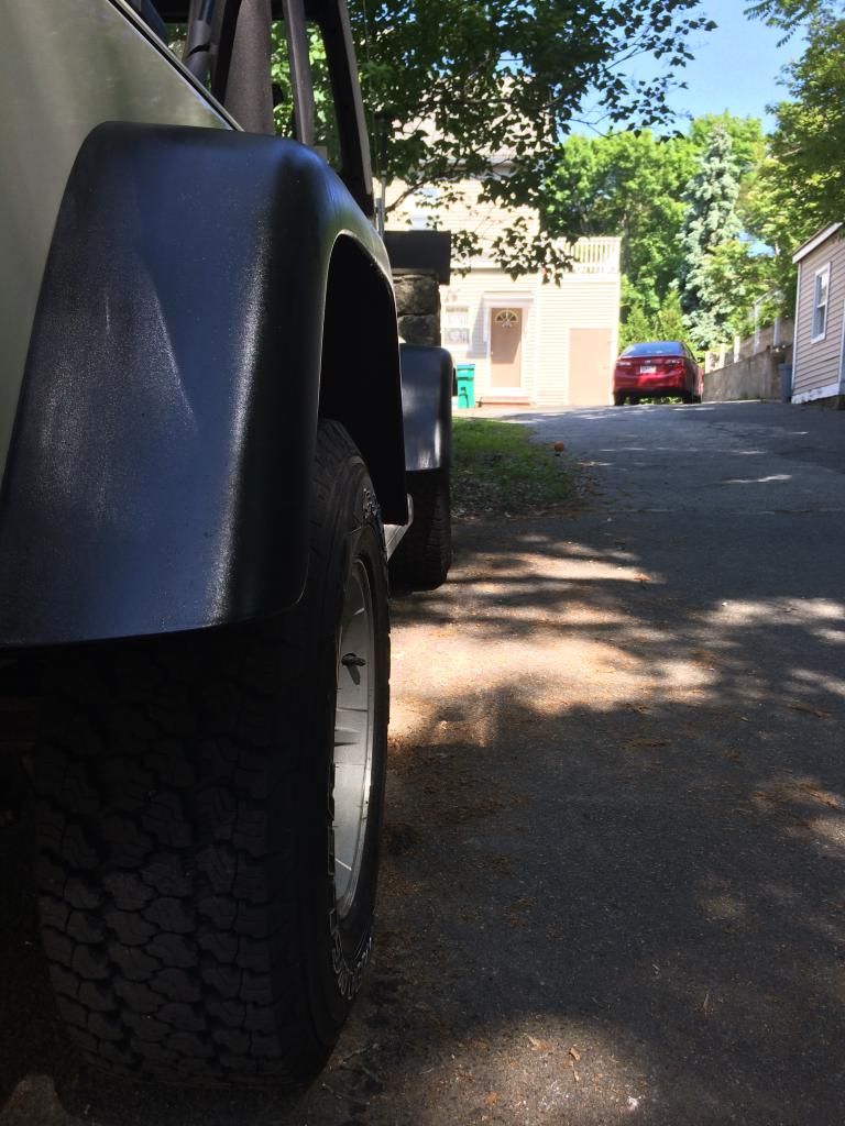

Some different angles of the new flares. They should be perfectly flush with the new tires:
And yes I shined up the flares. They were quite dingy before.

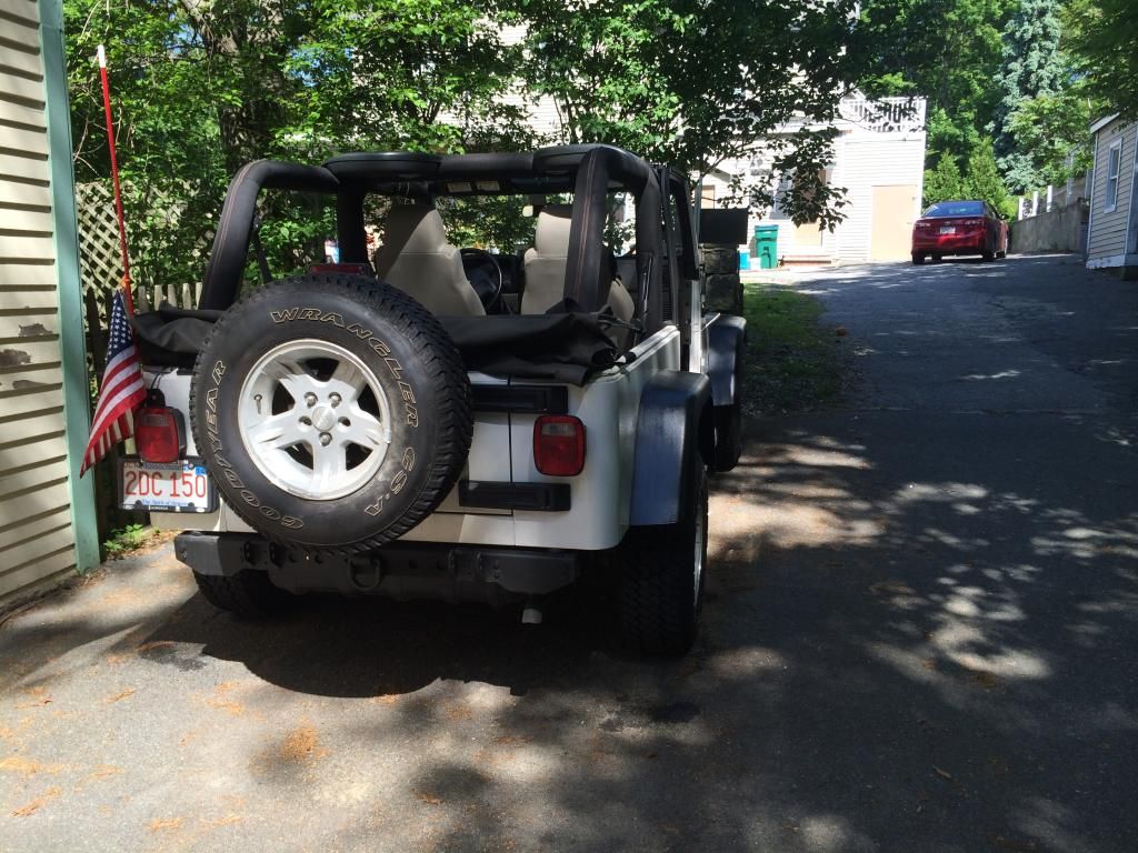

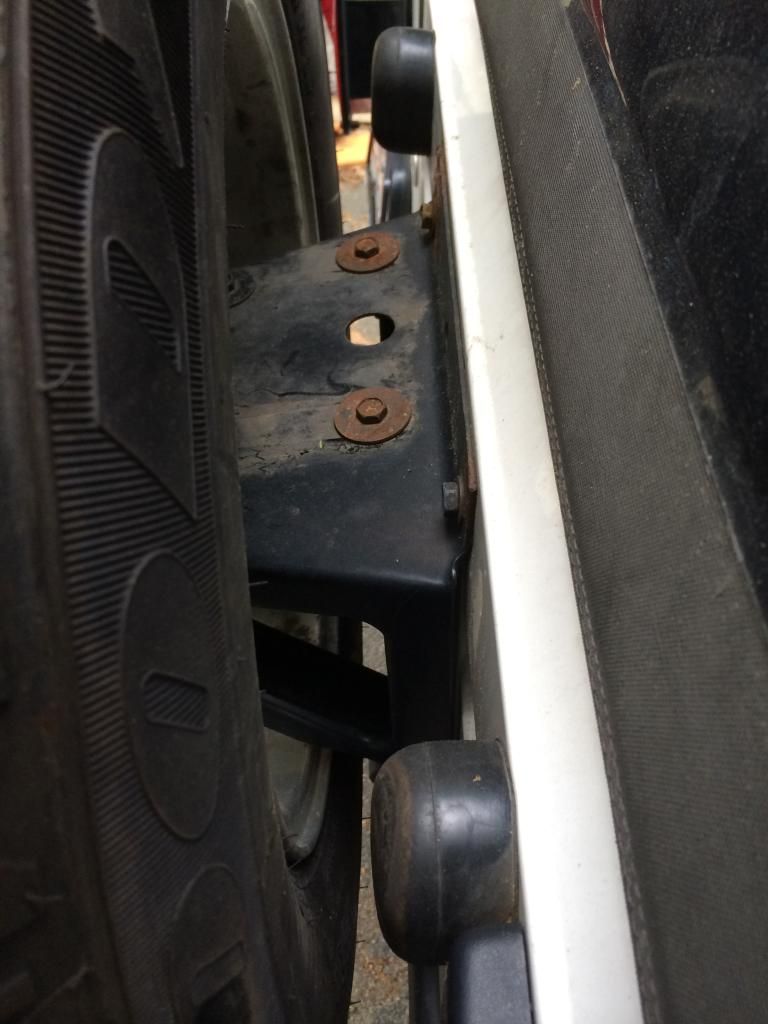

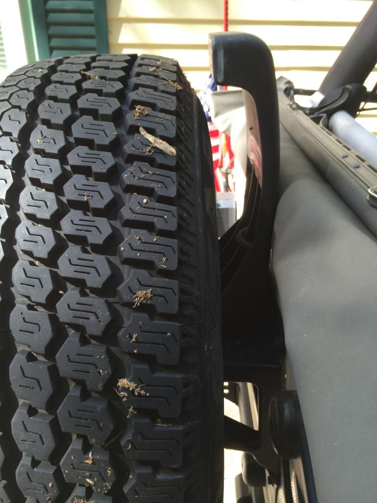

Last project was the teraflex spare tire relocation bracket. I am not sure I will keep this once the replacement wheel spacer comes in. I had to use a few washers on the bottom lug due to the wheel contacting the tire carrier on the inside edge:
I also removed the CHMSL as it would have not allowed the new tires to clear. There was barely enough room with the teraflex bracket and a 9.5" wide tire:

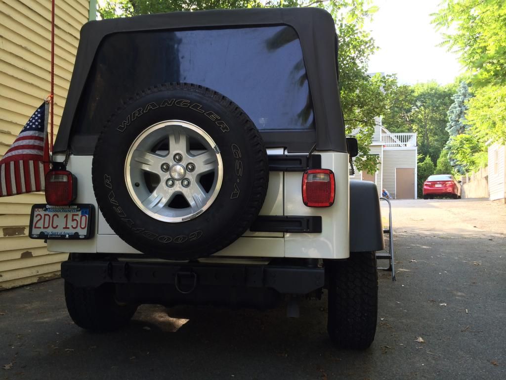

The replacement spacer came in today. I can't recommend Precision European Motorwerks on Amazon enough. If nothing else for their excellent customer service. They got me a replacement out in under a week.
I think this is going to be a better solution than the Teraflex mount. I may have to clearance the bumper pads a hair. It will be pretty close which is good for keeping the tailgate happy.
