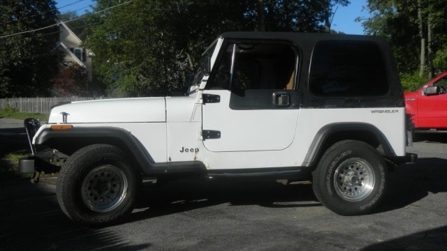

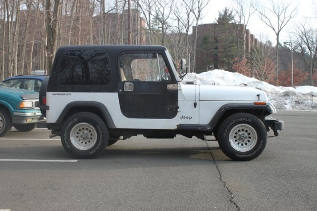

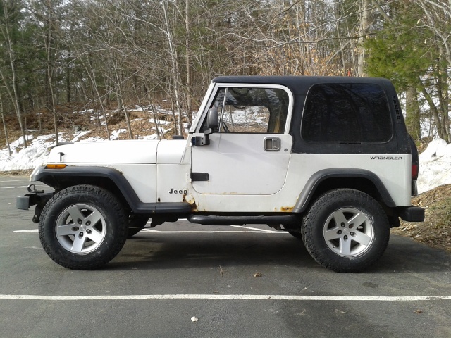

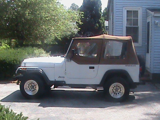

Well everyone, the day I've waited nearly three years for is finally here. Now that I've moved on from broke college kid to semi-broke post-grad, the transformation is complete. Here's a refresher both for me and everyone else as to where she started and where she is:
August 2010, the day(ish) the Jeep was purchased off my younger brother for my 1993 Corolla and $400 cash.
February 2011, shortly after purchasing hard top off of a fellow '92 and doors from an unknown year CJ7.
August 2011, doors are finally painted to (somewhat) match the color of the Jeep, and have working locks; side steps added for protection.
And here we are today, March 2013. Those same doors are fully painted (no more vintage look, for now); rear bumper from a 2003 TJ replaces the factory bumperrettes; 1.75" Crown Auto lift installed; 245/75-16 General Grabber AT2s on 16x8 TJ Rubicon Moabs replace the 235/75-15 Goodyear Wranglers on 15x7 American Racing Outlaw IIs; and unseen to the naked eye is the replacement AX-5 transmission from a 1994 with external slave cylinder (more on that whole nightmare to come in a later post).
Today folks, I am a happy man. There's a whole bunch more I'm going to include in a follow-up post, but this is a pretty good look at the cosmetic and function stuff. Things continue to evolve with it, including the rust as you can see through the photos, so as you all know the job is never done. I was hoping to be able to test the new performance this weekend in a camping trip, but Mother Nature is giving me a big middle finger with this storm coming Thursday.

Re: The Oreo (T.J.'s YJ)
Yay!
Don't it feel awesome? The wait makes it all the sweeter.
Looks good. It looks like they'll tuck quite nicely too, which should help in all sorts of areas.
Can't wait to hear how it performs!
