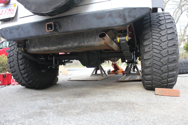

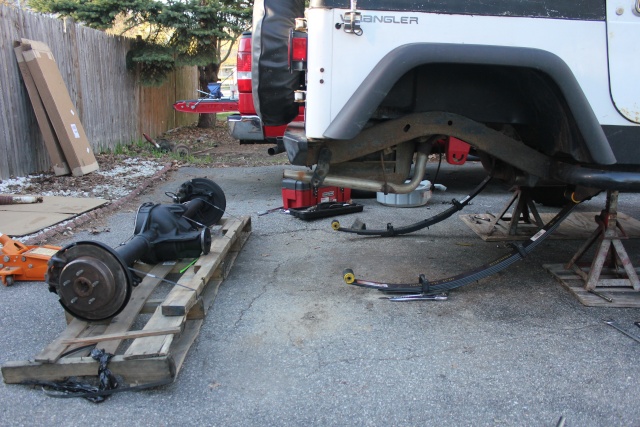

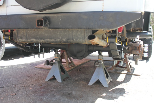

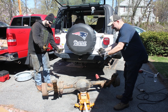

So after 21+ hours of work over this past weekend, both the 8.8 and the 2.5" Old Man Emu lift have been installed. The 8.8 is sporting 4.10 gears, disc brakes, and a full-time Spartan Locker, and the perches were burned on at an angle to work with a SYE and accompanying CV shaft. We stuck with factory axle shafts for now but in the future may upgrade to chromoly units. We went with OME heavy duty rear springs (#CS036R) with greasable rubber bushings on all four corners to account for the hard top we run in the winter and because we plan to eventually add a winch and/or heavy duty bumper.
8.8 and rear spring install
Shockingly the D35 came out with not too much effort, which was aided by the fact that we just left the old springs, shocks, and e-brake cables attached to it. Even the brake lines going to the junction block didn't put up much of a fight and came off with what I would consider very little effort. The e-brake assembly put up a bit more of a fight but my father tackled that part so I can't say from firsthand experience exactly how difficult it was. Our impact gun was a godsend and made everything exponentially easier, and luckily it fit in 98 percent of the places we needed it to go.
The hardest parts of the 8.8/rear springs install were installing the bushings into the springs; lining up the centering pins on the springs with the spring plates on the axle; and getting it properly centered underneath the Jeep. It took a lot of u-bolt loosening/tightening and yanking on the axle, but we got it done. The 8.8 did not come with a track bar mount, and I had already cut the old one off the D35 anyway, but if we had had to re-use the factory track bar the axle would have been a good deal off-center. I did take the time to completely remove the remnants of the upper end of the rear track bar just to be sure nothing could pivot and damage any moving part. As it sits now the axle is basically dead-on perfect side-to-side and front-to-back, and both rear shackles are almost perfectly vertical with no lean to them. The u-bolts that came with the axle were extremely long so I took our 4.5" grinder with cutting wheel and made quick work of gaining us a little more ground clearance.
We did run into a few minor issues with the 8.8 install:
First, the shock tab holes are not big enough for the stock bolts to pass through. This one I'm really upset about because this is clearly an issue with the mounts that ECGS burned on the tubes. We will likely widen the holes with a drill to get the bolts to pass through, and though this isn't a huge deal it's still something that we should not be something we're dealing with considering the hefty price we paid for the thing.
Second, the pinion yoke ECGS sent us is a one-piece unit, meaning the u-joint needs to be pressed into it. I was anticipating that it would be a strap-style unit like the factory yoke, so unfortunately we were not able to get the driveshaft installed yet. This one I'm not really upset about because the one-piece unit is clearly stronger than the factory style, it just sucks that we couldn't hook things up in one shot.
Third is that the factory soft line to the junction block is too short for the amount of lift and flex we now have. This is a fairly quick fix, and amazingly NAPA actually sells a line specifically designed for lifted YJs and is 4" longer than stock. Unfortunately the joint where the soft line meets the hard line looks VERY rough so we may have this line installed for us.
Last is that the passenger side e-brake cable that we ordered did not show up with the axle, so as of right now the e-brake is not connected and is just sort of dangling from underneath the driver floor. This will be addressed as soon as that shows up.

What's left
All that remains now is to hook up the rear driveshaft, install the new brakes lines and bleed the system, install the new (and longer) Skyjacker shocks (the current Ranchos are not only too short but pretty much non-functional), have an alignment done, get the e-brake squared away, order an aftermarket rear diff cover, and perform the new gear brake-in procedure per ECGS' recommendation. It sounds like a lot (and it sort of is) but in reality the difficult parts are taken care of.
It looks like we probably will not be getting the SYE kit installed before Go Topless Day/MaBell like we had hoped. Running MaBell will depend on the driveshaft angle/how much of the shaft is sticking out of the slip yoke and whether or not we have enough time to complete the proper gear break-in procedure like ECGS recommends. We don't want to thrash on the thing and risk prematurely destroying the new gears and subsequently voiding ECGS' warranty should something unforeseen occur.
Unfortunately we ran out of light so I don't have any photos yet of the final product buttoned back up, but I will post those as soon as I have them.

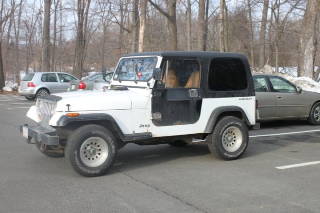

Here's a few photos that show the progression over the last five years:
Started here (circa August 2010:
To this (circa February 2011):
To this (circa May 2013):
To this (Circa May 2014):
To this (circa November 2014:
To this (circa February 2015:

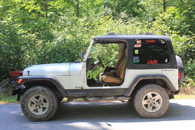

To today:
So that's where things stand for now. I'm looking forward to rolling into Go Topless Day for the first time since like 2011 without a hard top on, and then hopefully tackling MaBell the next day. She's slowly turning into the beast I always hoped she'd be.

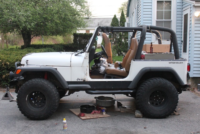

(I'm going to preface this post by warning you that if you don't have a good 5-10 minutes to read it, you should probably move on. It's a decent read, just a bit wordy.)
Had some extremely interesting experiences with the YJ these past few days. As some of you might remember my father and I were concerned at MaBell because the Jeep had a pretty decent oil leak going on. After poking around some after the run we determined it was the oil pressure sending unit, which we had experienced previously on my Cherokee. We were also having an issue with a really low idle on the trail after getting off the gas. This had been happening for awhile and I knew it was the IAC valve and had just been putting off replacing it. It finally got annoying enough that we had to do something about it.
Last Friday I decided to take care of these things, as well as give the Jeep an oil change to go with the new sender. It turns out the old sender wasn't actually leaking or bad at all, it was just not tightened at all. I literally twisted it off by hand; when I removed the dusted one from my Cherokee it was so tight I was afraid it was going to snap in the fitting. So that explained the oil leak and oil all over everything. I also decided to just replace the IAC valve instead of cleaning it simply because the one on there was original (i.e. 23 years old) and it may have been permanently fried. Turns out this was a good call because the original barely had any carbon deposits on it so it wasn't simply it being dirty causing the issue. During this time I disconnected the battery to reset the computer and have it 'learn' the new sensors.
And so we come to the oil change. The removed oil was black but no signs of anything other than oil, and no signs of anything in the filter (though I didn't cut it open). I was a bit of a dummy and bought 10w-40 instead of 10w-30 so I had to wait a bit for my old man to grab some on his way home from work. Once I had the correct oil in, I plugged the battery back in, ran the engine code check (which showed nothing), and cranked her over.
Having been taught to look underneath the vehicle and check to make sure everything is hunky-dory, and having heard a strange metallic noise after it started, I looked underneath the Jeep to see that four quarts of brand new oil had decided they did not want to be in this particular motor. I immediately shut the thing down (couldn't have been longer than four seconds of running), attempted to get the catch bucket under the Jeep, and immediately signaled for assistance.
Once reinforcements arrived, we determined that the oil filter blew off the motor and came to rest next to the left rear tire. Mother fucker. My father and I then spent the next half an hour attempting to clean the 2015 Exxon-Valdez spill so I could crawl back under the thing and put the old filter back on and make sure the threads on the filter adapter weren't cooked. After I could crawl under there without too much oil dripping on my face, I determined the threads were not cooked and the old filter went back on. Filled it with oil (again), did some heavy praying, gingerly turned the key, and was met by much better results this time. Oil pressure was up, the Jeep actually high-idled for the first time in years, and it seemed we had escaped what could have been a much worse situation.
And then that much worse situation happened. After driving the thing all weekend with no ill effects, my father decided to drive it to work Tuesday morning. Shortly after merging onto Route 3 in Burlington my father reports that smoke began pouring out of the engine bay and the oil gauge showed 0 psi (those of you who have never been in a YJ, please note that the oil gauge is above the radio basically in front of the passenger seat). So my father immediately shut the thing off and coasted into the breakdown lane where he remained until a flatbed showed up to get him. The Jeep had once again blown the oil filter off the motor, except this time the motor was hot and run at highway speeds with little to no oil in it for an unknown amount of time.
I spent my day Tuesday reflecting on all the good times the Jeep and I had together, and how tough she was, and how I knew it would be my father who ultimately killed her, and looking for a replacement motor. I was reasonable and knew there was no way that motor was ever going to run right again. That was until I received the following message at 4:43 PM, which read:
"SHE'S A TUFF BITCH A TUFF FUCKN BITCH"
Somehow the fucking thing survived unscathed. Our mechanic had removed the adapter and cleaned the threads (which he said were actually fine), so my father picked up a cheapie Fram filter on it and the two of them filled it up, and wouldn't you know it the damn thing didn't miss a beat. I told my father earlier in the day if the motor wasn't fried (which I thought impossible) I might actually have to willingly step foot into a church and accept that there really is a higher power out there, and I'm almost beginning to think there might be.
Once I digested this legitimate miracle, the brain trust of myself, my father, and our mechanic began trying to figure out what the hell caused all this bullshit in the first place. We have settled on one or more of the following causes: 1) the new filter was junk from the start; 2) the old filter should have been really cranked down because the gasket was compressed and used; 3) the pressure relief valve in the oil pump is possibly being blocked causing massive pressure build-up now that everything on the motor is tightened/on properly.
Regardless, the Jeep is still alive and should continue to be alive for the foreseeable future. I believe Tuesday's event exhausted life #8 of 9, so we're getting pretty close to the end of the line here. Moving forward the plan is going to be to replace the oil pump as well as the oil filter adapter. Hopefully that takes care of things.
