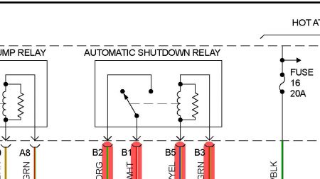

Post  Mark 7/19/2013, 6:34 am
Does it have spark????scratch scratchscratchscratch
Check for spark first, it is easiest thing to do and if you have it you can rule that out.
For all you know,, you could have set those codes after initial start up after you worked on it .
They could be erroneous codes, you may have set them and they mean nothing.
,,ASD relay controls injectors,,
,,,Check fuse no.6 30amp and test for power at B1 and B3 at ASD relay.
http://www.2carpros.com/forum/automotive_pictures/12900_asd_2.jpg
http://www.2carpros.com/questions/jeep-wrangler-1997-jeep-wrangler-no-start
