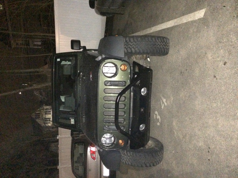

As shown in my other thread here is my first mod. A Poison Spyder brawler lite with skid plate
I am still not sure why the pictures are sideways..
The next thing i'll be doing is swapping out the stock draglink and tie rod for Synergy replacements. I was doing a check up on the jk (as ill be driving it for jeep beach in Daytona next month) when i noticed that my 5 months and about 4k miles TRE were starting to show up and down play as well as a noticeable clunk while cycling the steering.
I also ordered a rough country steering stabilizer relocation bracket. I figured a mother 20 bucks to save it from trail damage would be worth it.
Hopefully this weekend ill be putting these parts on and will update with pictures.

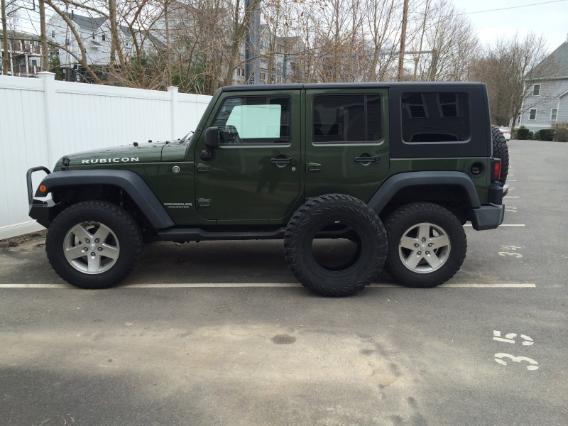

I've been a bit lazy posting up pictures (got the Synergy tie rod and rag link installed already) but today i am excited. just received my 35' mtr w/ kevlar tires.
But i have a dilemma for some reason the front springs are #14 (why i don't know
) i always thought Rubis had stiffer springs. at any rate its currently sagging enough that i have about 1 inch of travel before bumpstop.
the question is to mount the tires and put them on the JK (hopefully no rubbing unless disconnected) or will i be rubbing over every bump?
obviously the tire with no air and no load is pretty big but i assume that once mounted and at about 28-30 psi i will have just about (hairline) enough clearance left.
theres a pretty good deal over at krawl-offroad.com where i can get Rock Krawler 2.5 progressive (triple) rate front coils for $125 shipped. it seems like a no brainer that i need these as oppose to going on craigslist from some stiffer stock springs that would sag anyways.
any input guys?
any input guys?

Re: My JKuR build
sexy!
If you have one inch of travel before bumpstop, then you'll most likely hit your bumpstops before you have to worry about your tires getting into the fenders...
However, I'm not sure on the backspacing of JK rubi wheels but you'll most likely rub when steering on whatever they meet first. probably coils or the bucket. Maybe wherever the sway bar is for you weird JK guys...
How long you plan on runnin the 35's stock? I'd imagine it would get annoying to run them for weeks on end like this..few days won't hurt

I ran 315/70R17 Duratracs on my JK with a Rough Country 2.5 spacer BB and cut fenders with no issues.

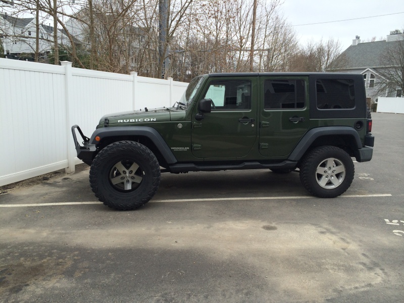

Took out the teraflex spacer in the front today and got way more lift than expected from Rk 2.5 inch springs even with a fornt bumper and skid plate. But hopefully the springs will settle down a bit.
Still dont understand why they pictures are sideways if they are taken vertically. Tomorrow will finish up with a before and after picture

Got a bit busy and kept forgetting to take pictures but here they are
#1 factory coil plus 2.5 inch space with steel bumper mounted
#2 RK 2.5 triple rates with steel bumper installed
Sorry for the sideways pictures but got back just a tiny bit more than 2.5 of lift with the springs !! Now it doesnt feel like im driving a dropped honda civic

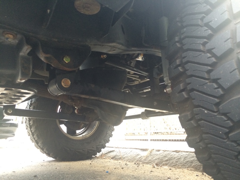

It's been a while since i made any changes to the jk but in the last month i've added: Rancho control arm drop brackets to get caster back in its happy place and get rid of the flighty steering from a lift with stock arms
Rancho rs9000xl adjustable shocks
I also just added the teraflex rear trackbar raised bracket to improve roll center.
Here are some pics
Here are some pics

I've never seen control arm drop brackets, must be a JK thing. Do a lot of guys use them? I'd imagine it would suck to get the arms hung up on more obstacles but the onroad handling and offroad movement of the CA's must be huge benefits
Tonellin- Rausch Creek
- Posts : 313
Re: My JKuR build
It's Looking Good!
Some companies manufacture them brackets for the TJ's also.
More of an on road thing ? as the arms are back to what looks like stock angle with the brackets, which would probably help handling at high speeds..
You can see where it looks like the oe bracket hit before,{maybe it didn't} but now it's kinda hindering the goal of obtaining ground clearance.
It looks like they are going to hit rocks, stumps etc, more often than without them and that's not good for the arms and brackets.
Just try it out that way and crawl the smaller rocks and such. ,,,MY 02,, Nothing more.

Re: My JKuR build
Yea the stock bracket has hit before and i expect these to hit again. But its risk vs reward. Driving with the brackets is completely night and day difference jeep is not flighty now its controlled and predictable plus i no longer get a nose dove when braking. I considered adjustable control arms but the brackets do so much more in adjusting the angles at a cheaper price (about $125). Its worth it for me as i do a lot of highway driving and towing.
I've only had the chance to go out on the trails 1 maybe two times this season( i would like to be out more often). And if i bang them up pretty bad the stock arms are on CL all the time real cheap.
