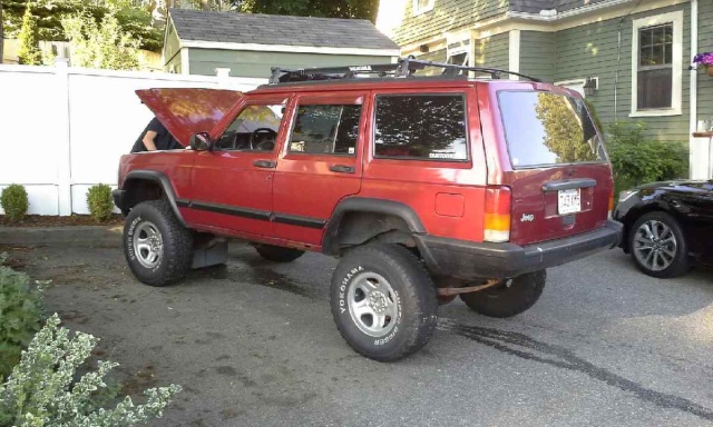

Everyone, I'd like to introduce you to Little Red, my new project. Picked her up this afternoon for a cool $500. She is a chili pepper red 1998 Cherokee, 4.0 auto, Rough Country 4.5" coils up front with Rough Country 4.5" leafs out back (with 2" shackles for about 6.5" total), Chrysler 8.25 out back, transfer case drop, Rough Country (I think) adjustable track bar. It's currently sitting on crappy 31/10.5 no-name mud tires on factory rims with a second set of near perfect 32/11.5 BFG Mud Terrains (one has a hole) on Grand Cherokee Limited rims thrown in. Power everything (and it all works!), remote start, alarm system, FULLY FUNCTIONAL A/C, and a blown sub that I most likely won't use in the back. It also came with a roof visor, roof rack, and 2" spacers for the front (to possibly level it out).
Its one weak spot is the motor which has almost 277k miles on it and a pretty decent lifter knock, but nothing too atrocious. I went to check it out with the intention (and pre-established agreement) of paying $700 for it, but while taking it on a test drive the water pump shit the bed (hence the stream you can see in the photos) so the previous owner said $500 to take it off his hands or it was going to the junkyard. Just from it running in the driveway we knew it was going to need a pump, so knocking $200 would basically cover the cost and installation of a new one. It would have been a sin to send this puppy to the scrapper so we pounced on it.
Two hours later AAA dropped it off at my parents' place (at no charge), we exchanged the cash for the title, and here we are. Originally I thought it had the 35 out back (PO had no idea what it was), but I ran the VIN on Jeep's website and the build sheet says it's an 8.25 which I'm very pleased about. It makes my decision a lot tougher though as to which one of my current projects becomes the "dedicated" wheeler and which one becomes my DD. Right now I'm leaning towards Little Red because of its options, but since the water pump is junk it can't be driven now anyway so Oreo isn't going anywhere yet.
Girlfriend's pissed, mother is pissed there's gonna be more Jeep shit at the house, but as far as I'm concerned it's game on for more Jeep fun.

Sweet deal TJ, thats a nice cherokee!

I'm jealous. I love XJs. I say keep it as a DD unless you want to go all out and get MetalCloaks new suspension.
Re: Little Red (T.J.'s XJ)
Nice! That's arguably one of the best years too (97-99). Honestly, as I'm sure you know that engine could very well take you another 100,000 miles without issue.
I imagine you probably don't want to dump a ton of money into it, but I would have to say longarm is the way to go if you ever do upgrade the suspension.
I also have the 4.5" rough country, though also running 2" spacers in front and lift shackles in the back.. after sag.. I measure 4.5" of lift. Trim those flares out though for maximum flex and tire clearance
. Have you had a chance to throw the 32's on? I haven't tried running without the wheel spacers that came on mine, but I'm prettty sure the 33's would rub at full lock without them.
Looking forward to seeing how this goes!

The only thing that worries me about driving it everyday is the slight motor rap, but I think a new set of lifters might actually help to cure that. It does have a crack in the exhaust manifold as well that makes it pretty loud in the engine bay, but I knew that going into it and for what I paid I consider that routine new purchase maintenance. Definitely true that these motors run forever...unfortunately forever is pretty much 300,000 miles as far as any engine goes so she's gonna need some love in that department for sure. And truth be told the only reason I considered it at all is because it is a '98 or '99 with the bigger stronger u-joints and high pinion up front, and the potential for the 8.25 with 29 spline shafts (which ended up panning out). Working A/C didn't hurt its cause either.
Gas mileage does play a part in all this as well (I know, I know), as the YJ is now getting close to 17-19 miles to the gallon with a mostly around town/occasional highway mix. If you ask me that's pretty damn good for a 22 year old under-powered, over-tired four cylinder. I'm willing to bet I'll get close to 20 mpg on the trip down to Rausch as long as traffic isn't miserable. Everything about this is a tough decision for sure. That being said, I really miss my soft top in the summer, so it would be nice to have the XJ to use for my camping trips (I mean look at all that room back there for gear) and the hardcore wheeling, and the YJ to drive around and take on some of the lesser extreme stuff.
Since this is a tag-team build with my old man, his one major concern is that it doesn't have a cage. I don't see it the same way because frankly if I was to flop my YJ today I'm pretty sure there's a greater change of me getting hurt in it from either falling through my plastic window (it I even had it on) or something coming through it, or god forbid it rolled completely over and a rock busts through the hard top and smashes my head completely open. You can tell I've thought about this before.
I neglected to mention also that this baby was never wheeled (at least what most of us would consider wheeling), and honestly it shows. The guy I bought it off had had it for the last eight years and it was his baby. At one point he said he drove it to California and back (which helps explain some of the high miles), and for a short time he must have been living out there because it was previously titled there before 2009. He actually had the lift installed because he's an electrician and used it to haul around all his tools. I used to see this thing all the time parked in town and loved it; it always caught my eye.
When I saw the ad on Craig's List I knew exactly where it was and had my old man go down and chat the guy up because he wasn't returning my emails and left no phone number to contact him at. I couldn't get to town before yesterday and didn't want someone to jump on it first. He started at $1600 when he first posted the ad, then was asking $1200, then my father talked to him Wednesday night and they agreed on $700, then the water pump shit the bed and brought her down to $500. Funny how things work out sometimes. The guy who sold it to us was a young guy probably a few years older than me, and it sounds cheesy but he was glad to see her go to people in town and people who'd give it a good home. Smiles all around when it got dropped off at my parents' place.
I probably won't be able to put the 32s on for awhile, as the PO says the one with the hole just won't hold air when it's mounted on the Jeep. He said he hit a highway reflector (I guess there are actually people who hit those things) and had the tire patched from the inside, but no real luck. I guess it has a slow leak when off the Jeep but a pretty bad when when on there. Honestly I think I could get away with just buying one new tire and calling it a day, because when I looked at them (admittedly quickly) they looked like they had plenty of meat on them, I'd say easily in the range of 80+ percent tread. I'll get a better look at them this weekend when I'm at my parents' place working on the drive-able Jeep (it's gonna take some getting used to not just saying the Jeep).
And as you mentioned Jake, the PO said the 32s hit the LCAs around full lock, so spacers, a different set of rims, or the steering stop trick my be in order, even if they go on the YJ. It really depends on which one becomes the mule. The tires on the YJ are only a little over a year old and only have about 10-11,000 miles on them, and they hide it well. As far as the lift goes, it doesn't seem like it's sagged out back at all, and the rake compared to the front is noticeable when you look hard enough so it seems it's so far so good on the Rough Country stuff. The PO also has all the paper work from Rough Country that he says guarantees the parts for life (against breakage), and he's gonna drop that stuff off at my parents' place this weekend. It's not so much that I don't believe him and more that I didn't think Rough Country had that sort of guarantee...considering what poor things I've heard of their stuff.
