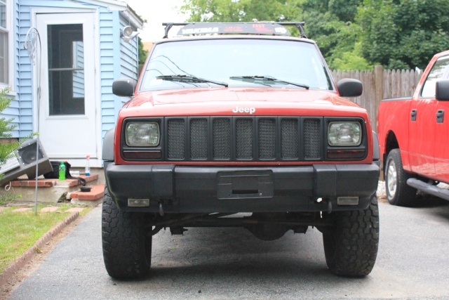

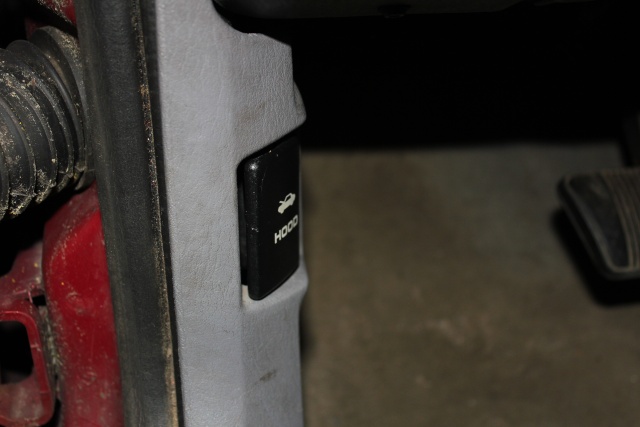

So, a good chunk of progress was made today. For starters, I found a shop in North Reading with extensive experience replacing exhaust manifolds on 4.0s. I was quoted $600 for the whole job, including the replacement of the obliterated motor mount. I know that's still a decent chunk of change, but compared with other quotes I got it's an excellent deal. I'm not sure when I'll be getting it down there, but it should be sometime in the next couple of weeks. Once the manifold is replaced it should be on the road shortly thereafter.
I was also able to get a good day of work in, including: the replacement of the broken hood release cable and the rear wiper arm; and the removal of the amp and blown sub and their associated wiring, the radio (which after testing is the reason the battery has been constantly dying), and wiring for lights that are no longer installed (the scary thing is the PO is an electrician, and this is some of the most hack-job wiring I've ever seen in my life).
I also had a chance to really take a look at the 32/11.5 BFG MTs that were part of the deal. Unfortunately the one with the patch holds no air at all. It loses it as fast as it takes it in. It's a real shame since the other three are definitely usable (on the YJ), but you have to play the hand you're dealt. I'll be scouring Craig's List for a set, or even a loner, so if anyone knows of anyone looking to move some definitely let me know.
I am still tracking down a slight issue with the defroster. It doesn't seem to blow out as hard as it should, and after taking off pretty much all of the dash panels the job is not going to be an easy one. It's probably a vacuum leak somewhere, but it's an issue for another day. The panels aren't all that hard to get off so that's a plus.
Of course, photos or it didn't happen.
And some glamour shots:

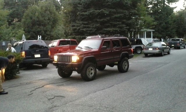

I did end up going to the junkyard this weekend, and picked up the replacement rear interior panels. They were a piece of cake to get out, but getting them in is probably going to be a little more difficult, as unlike at the junkyard I can't just cut my rear seat belts with a knife. I'll be putting those in in the coming weeks.
I also swapped on the 31s from the YJ, as it is now sitting on the 32s that came with the XJ when I bought it. I think the Moabs give it a real nice look. Once they're shined up a bit, and the rake is gone from the rear end, they'll look right at home.
I also had my first run-in with XJ electrical problems. I had the thing running to move it into the driveway, and looked down at the dash to see that the "AIRBAG" light was on. Random but OK shit happens. Then I noticed that the tach had bottomed out to zero. D'oh. Further inspection showed the cluster (minus the battery gauge oddly enough) wasn't doing anything. Good news is I shut the thing down and restarted and everything was back to normal. I've been told that they're notorious for electrical issues like this, and go figure I witnessed it first hand a few years ago in my buddy's Cherokee. The same thing happened where all the gauges bottomed out and noting on the cluster worked at all. It randomly started working a little while later. For now, no big deal unless it happens constantly or for extended periods of time.
Here's some glamour shots of the fleet "in action."
