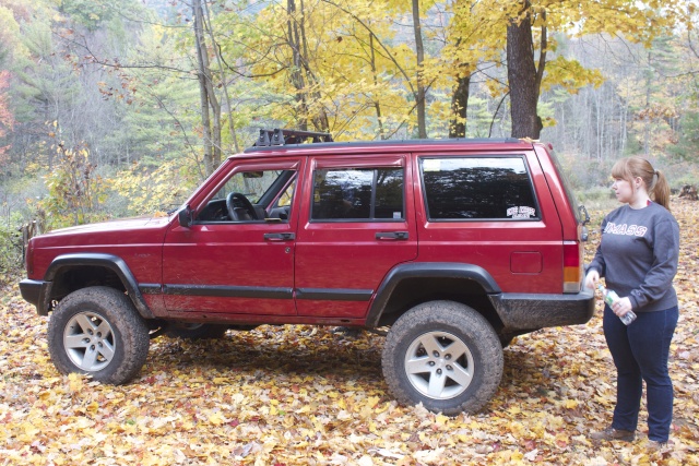

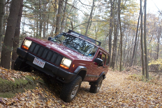

As promised, photos of this weekend's activities. I've got plenty more but for some reason I can't get them to upload. Not sure if it's on my end or the forum.
All in all I was happy with the flex and the overall comfort of the ride off-road. Much easier and more relaxing than the YJ. As I noted before my only real issue was with the wheel spin in 4-Lo, which you can see a bit of in the middle photo above.

Nice pics thanks for sharing
