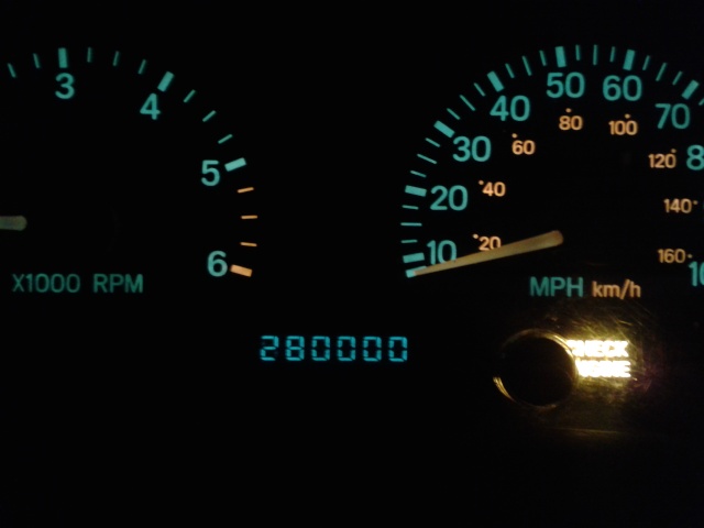

So I forgot to post this when I happened a few weeks back. Granted it's not on the original motor anymore, but I'd say the thing's in pretty good shape all things considered.

Welcome to the high mileage club!
I have barely got you beat with about 287k on mine but i don't use it much so you will blow past me soon.
